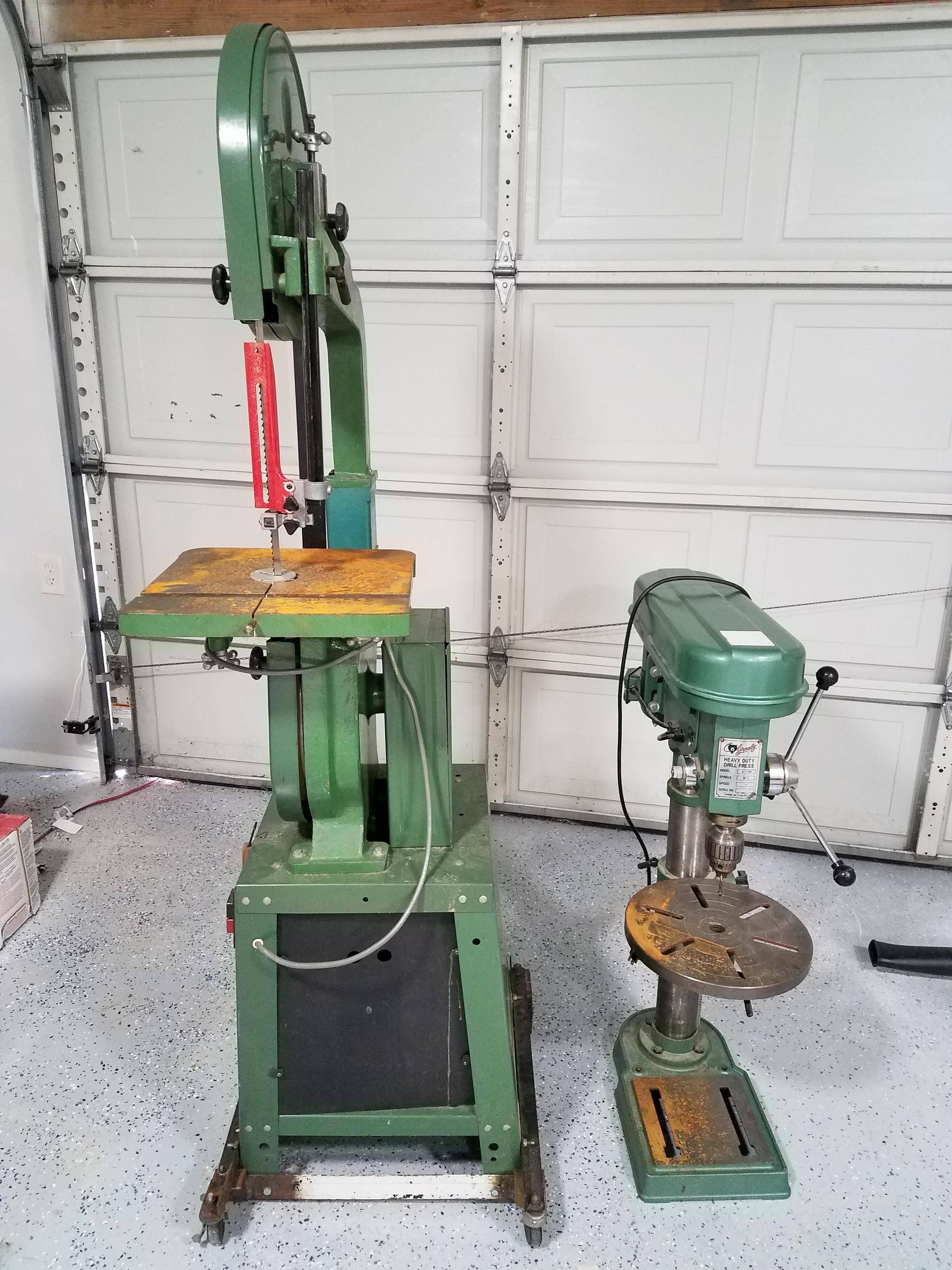

Hey guys,

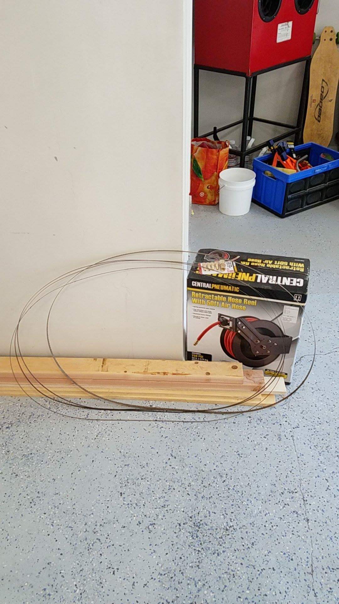

So I recently scored a nice big intergram WA-14 band saw on craigslist. It was hard to do research on the machine before going to pick it up as it is a bit older... not much info on google. Luckily there were a couple of spare blades with it so I took a string out and measured their length at a whopping 106 inches. Another quick google is not resulting in much in terms of 18tpi blades in 106 inches... anyone know of a good source for these?

Just a quick question as to why you are looking for 18tpi blades. Are you planning on trying to cut metal with this? You will likely need to modify the saw to do so as it is a wood cutting saw and will have too much speed to cut metal.
You've guessed correctly... Sorry, I'm very new to a lot of these machines and am working off the best chunks of information I can grab. Another friend told me I needed a band saw with at least 750 rpm and this one was around 1800 so I got it... is that TOO fast? :eek:

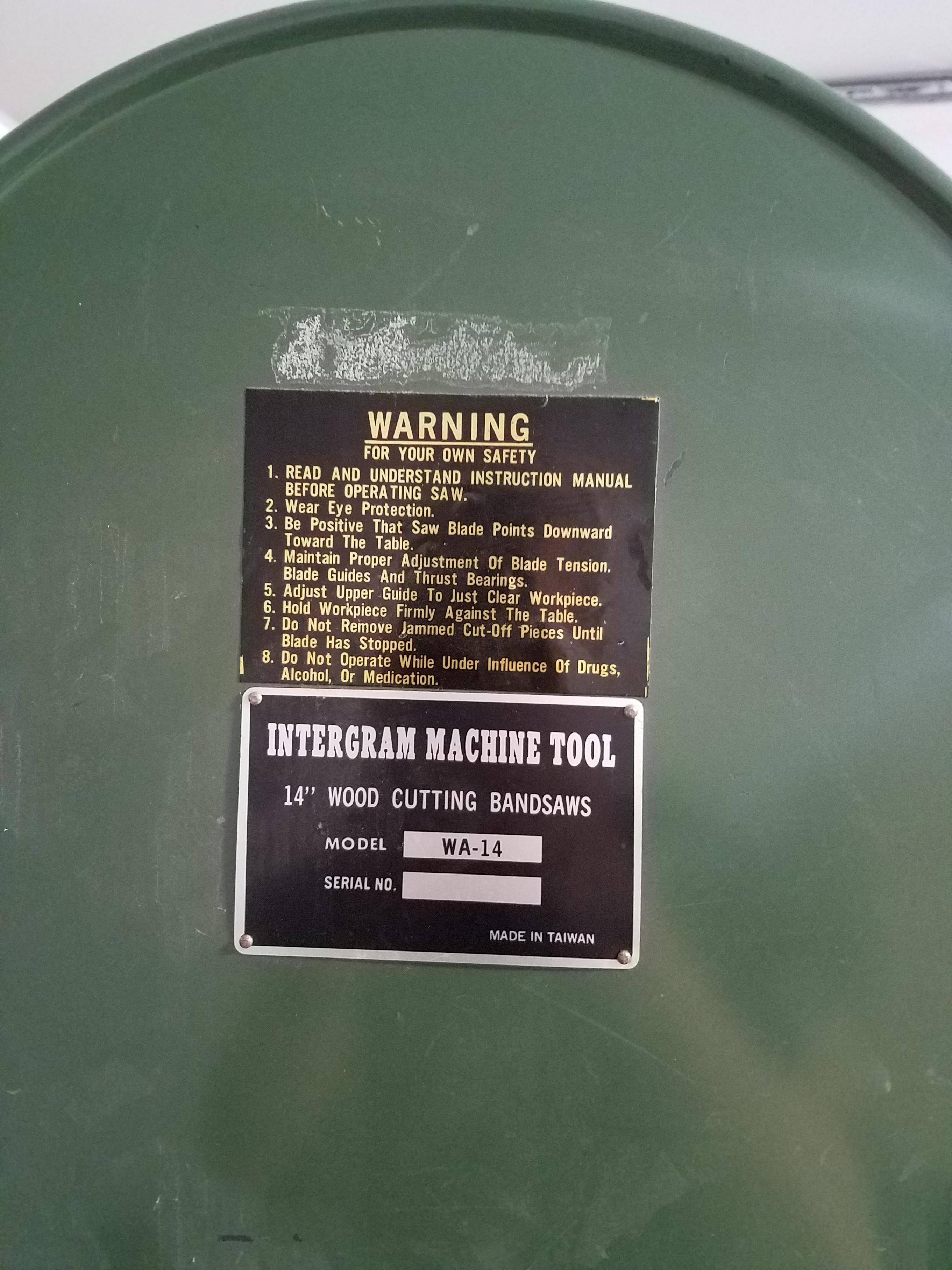

To me just the fact that is says "14" wood cutting bandsaws" on the side tells me it's going to run too fast for metal. Metal bandsaws like your porta bands and horizontal have gear reduction to get more torque and less speed. At the speed that thing runs you'll likely burn the blade up very quickly trying to cut metal if it cuts much at all.
You will have a nice unit for cutting scales material though. I'm not really sure it would be cost effective to modify that to get the speed you'll need for metal cutting.
RPM is the motor, that has noting much to do with the blade speed. For metal cutting of blade steel, you want the blade cutting at 70-100 FPM. You will have to gear the wood saw down a lot to get that slow. Most wood saws run 1000-3000 FPM. If the motor drives a regular V-belt, just change the motor for a 3Phase one and put on a VFD. Use the smallest pulley you can get for the motor shaft.

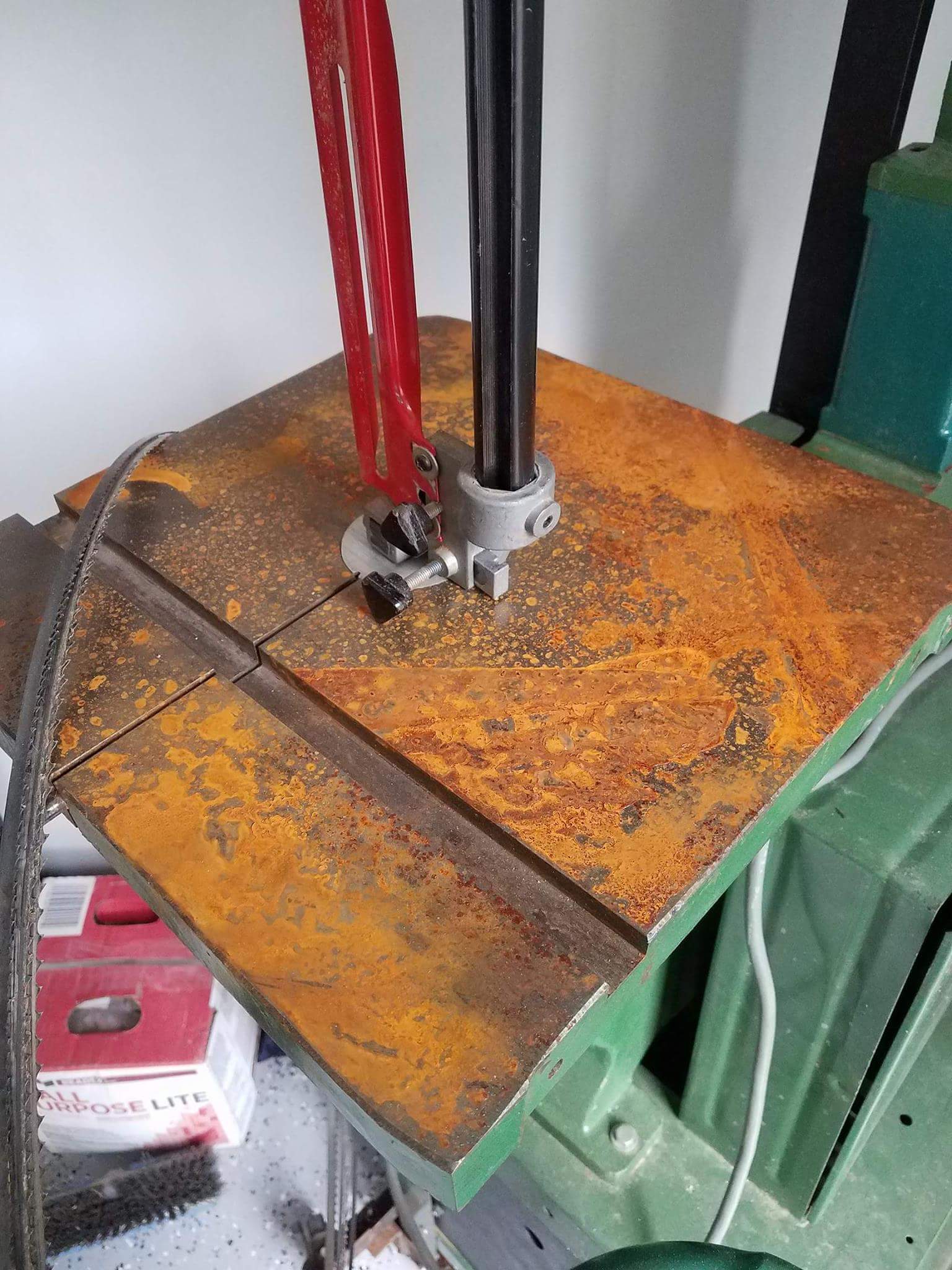

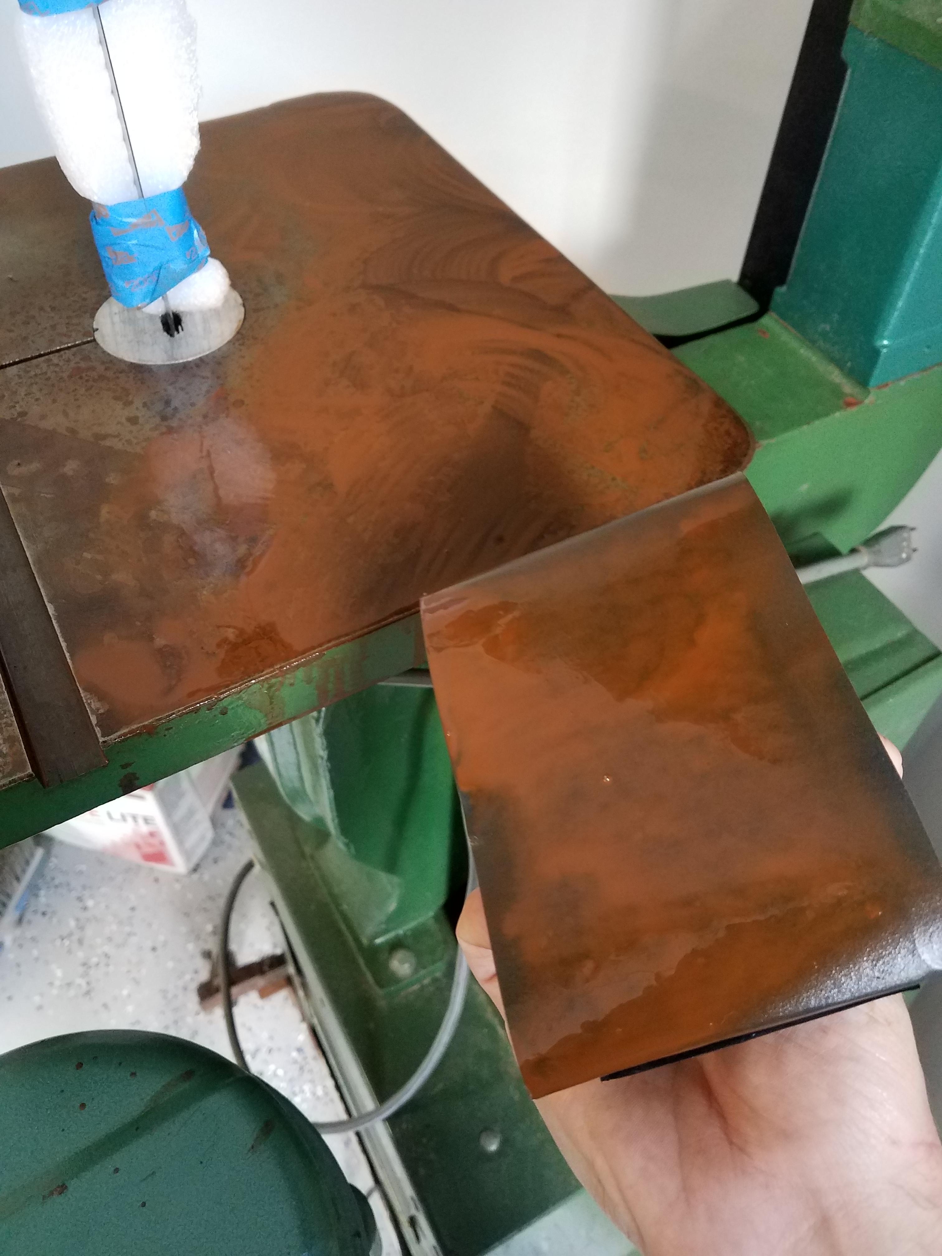

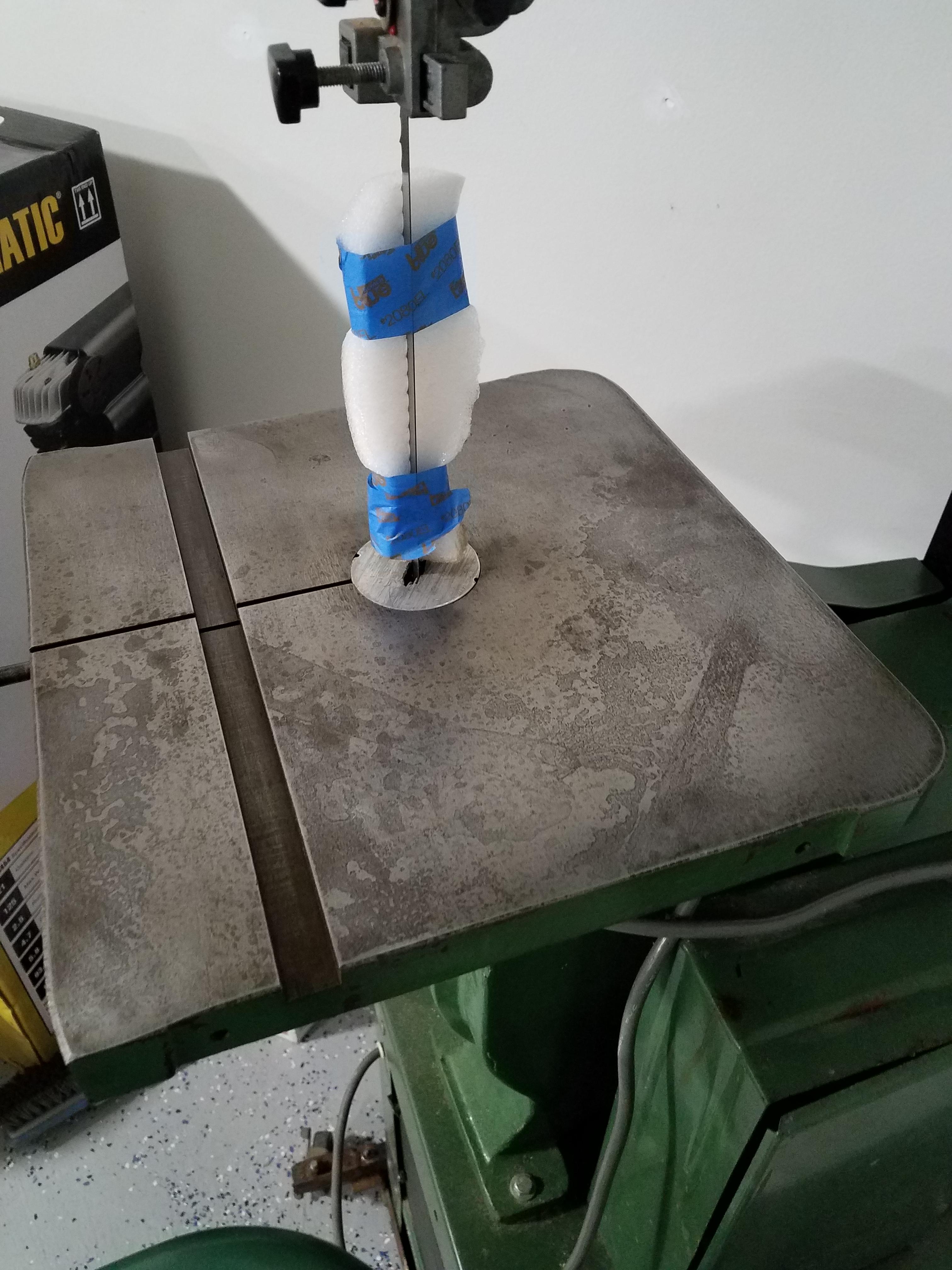

Thanks so much for the responses, guys. BandSawBladeDirect seems to have really good prices compared to what I was seeing elsewhere! I am chomping at the bit to get my rough profiling started.... Since I got this one for pretty cheap and restored it myself (pictures below after rust removal) I think I'm just going to keep it as a secondary wood/micarta saw and chalk it up as a learning mistake. I will go back to my original plan of buying the HF 4x6 horizontal/vertical.

You could set it up for metal, but you'd need gearbox, or at minimum a multi stage belt reduction. Look at the delta 14" wood/metal bandsaws for an example.
As for band length, that is a typical clone of the 14" delta, it has a longer band due to the riser block. If you remove the riser block it will take the standard and easy to find 7'9" bands.
As a side note it's easy enough to make up your own bands without a blade welder. Scarf the ends of bulk stock and hard silver solder the joint before grinding it back flush. There are videos which would describe the process better than I could.
