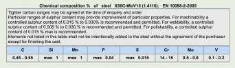

The knife itself is an A J Henckels International 8" chef knife, it would be there entry level knife, Made in Spain, for a serious home chef or restaurant chef, that retail for about $50.00 to $60.00 So I don't think I did too bad on it, not mention I've always liked Henckels knives. The little checker board near the handle from my understanding signifies the date it was made, however, I was unable to verify this. The steel is X50CrMoV15. Here is alloy make up of the steel.
I looks similar to AEB-L but with a little less carbon and a little more chrome and also with the addition of some vanadium. At first glance I would think the performance would be on par with AEB-L but I think that will most likely come down to heat treating. I did find a bit of information on heat treating that kind of confirmed what I was thinking when I honed the knife on some stone. I would glass this knife would be closer to HRC-56.

Pretty sure that's the asian version of german 1.4116 (AKA 4116 steel) which is a really common stainless alloy in Europe.
I did see that somewhere on the internet as well and I went back to look for it and couldn't find it. I think most of the steels used in drop forged knife blades are fairly low carbon and low in other alloys to make them forgeable and machinable, I don't think you can drop forge the really high alloys like s35vn. Even the Zwilling brand ends up with an HRc-57 or so. I don't expect the performance to be stellar. I think my AEB-L at 62 is going to out perform it, I only have to lightly touch my Santoku on a steel about once a year and it's hair popping sharp again. One thing that I think helps keep my knives sharp is my cutting boards are made of hard maple which isn't as hard on an edge as some of the exotic woods might be.
