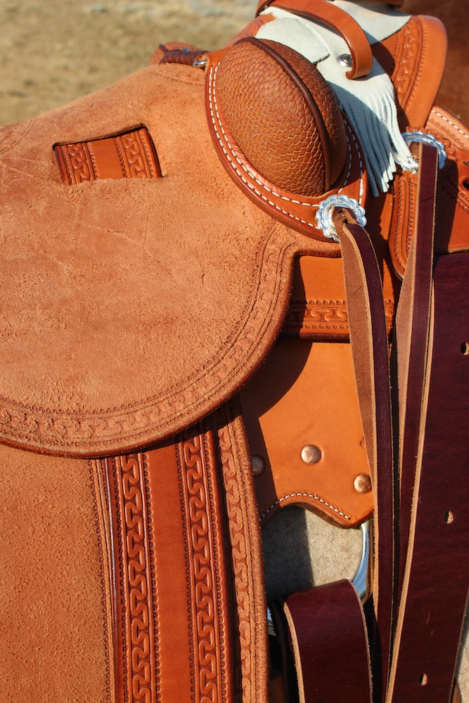

Here are those pics I shared with Strig a while back. This is my firend Steve's new saddle by Bob Ray. I don't know Bob but he did an amazing amount of little detail work in this saddle and a lot of tooling on roughout. Steve had brought the saddle over to show us and to put it on one of our horses as he was horseless at the time a dire situation that has since been fixed. Steve is the guy roping behind Nichole in that branding pic above.
A close up the seat and the beaver tail bucking rolls..
A close up of the fender and the out side stirrup leathers. Look at that itty bitty little border stamp he used. That took days.
The whole saddle. So this saddle is a half breed too, part roughout and part smoothout.
