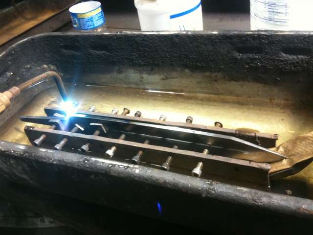

The focus of the second week was on making knives that would be able to pass the ABS J.S. performance test. The test however, is not an official test.

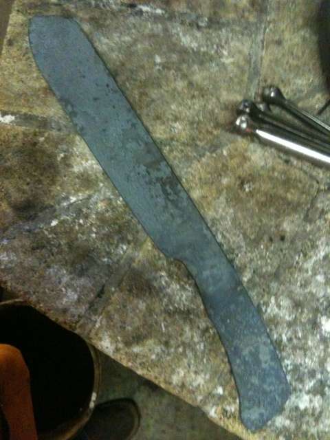

Here is the beginning of my knife. At this stage I have just shaped the point.

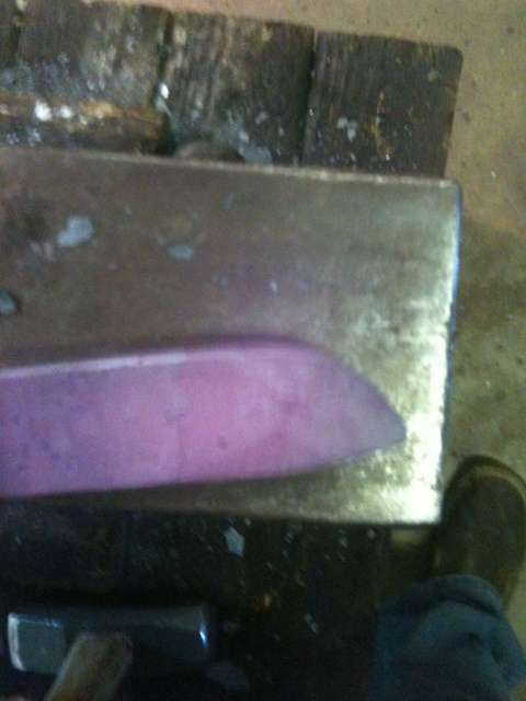

Then a trip to the power hammer to put on the bevels and a little refinement with the hammer.
Now another trip to the power hammer to taper the tang a bit then some more shaping with a hammer and anvil. We didn't do much with the handles as the knife is about to get bent. Most just wrapped the bar of steel with duct tape etc. for the handle. I just gave it a little shape and called it good.

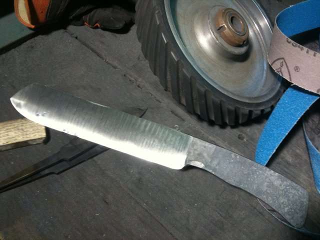

Then I do a little grinding to get it ready for heat treating. This is actually the last picture I got of it before I started the test.
