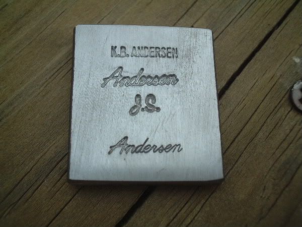

View attachment 701296 View attachment 701294 Here is the everstamp holder

Pretty simple set up. I had to trim the press rod a bit to fit the holder in, but using the press gives you way more control than whacking it with a hammer. You can really get it deep too.
I already had the holder, but I imagine it would be pretty simple to make a slotted attachment to slip over the end of the press rod that would hold the stamp. the holder wouldn't really be needed.
i just did, had a scrap piece of alum cube with a window and just milled out a 1/2" larger window to fit
press fit the stamp and i'll use some screws to align it
it's a quick way to get started and I'm sure i'll enhance it or make another one later.
