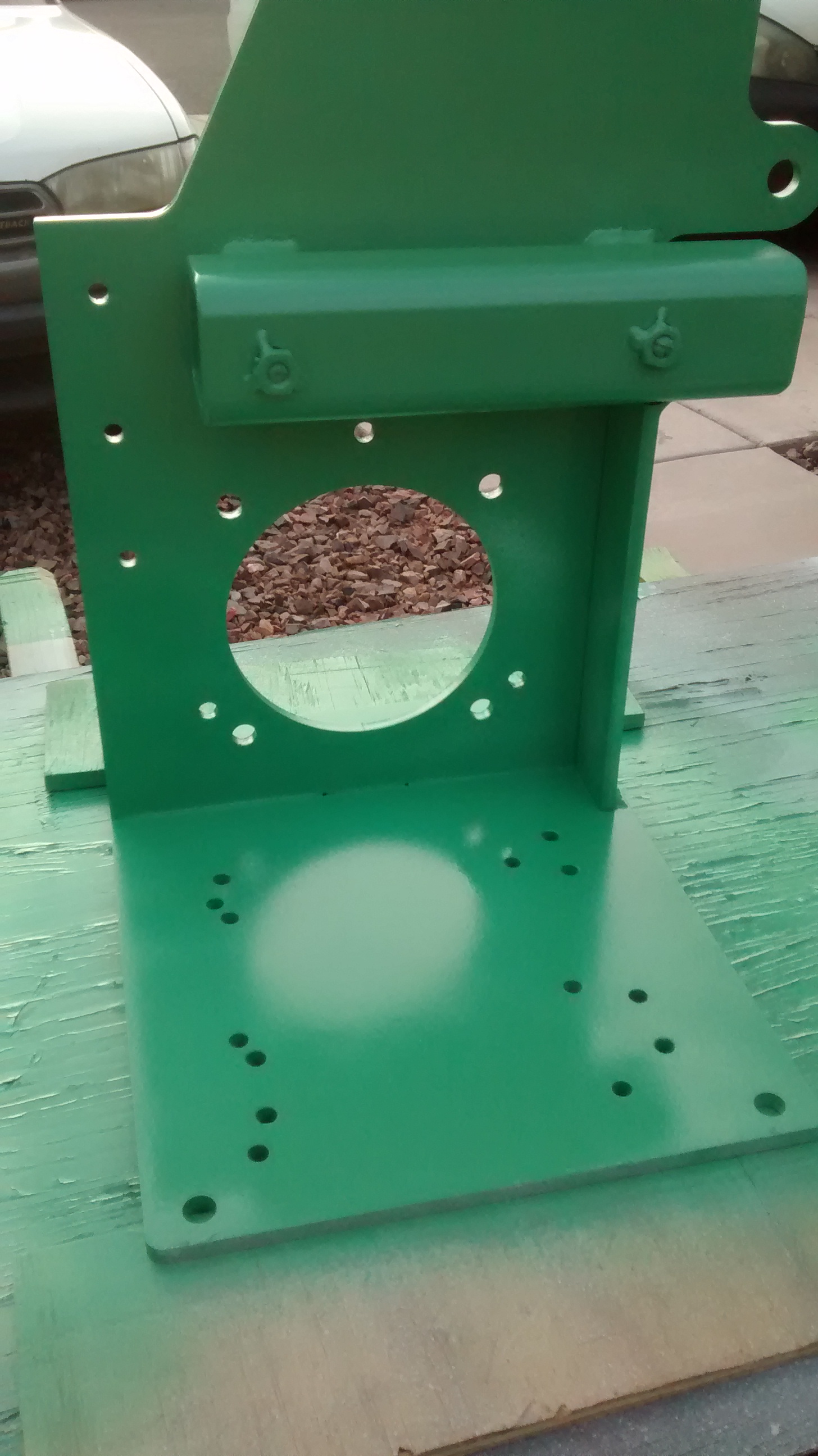

I'm also building a SLING grinder, but without a face mount motor. Here is what I did:
The motor had three screws holding the front on. I removed those screws and then marked their location on the grinder. I drilled those holes out and then screwed the motor onto the frame. I know the motor might not be square since the front isn't machined flat, but I figure I can shim the motor if needed. Then I marked holes for the foot and drilled those in the base plate. I bolted the motor on and then my buddy welded the frame up and added a tube for a tool rest.
I've removed the motor for painting, but hope to have a chance to finish putting it all together and fire it up this weekend.
