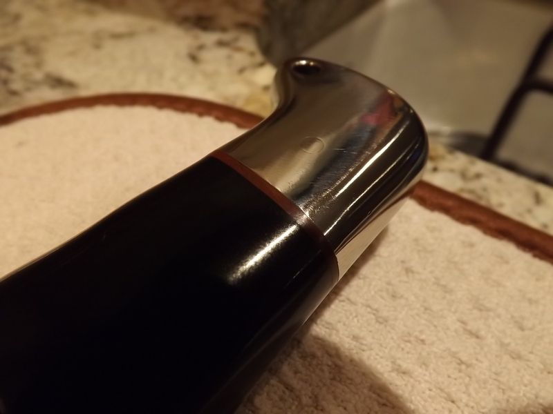

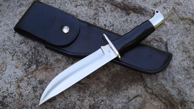

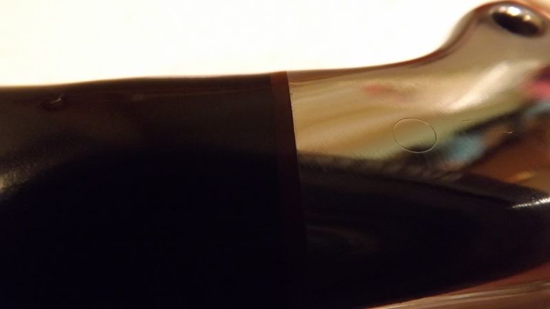

Thought I'd post a few photos. Not sure if the detail is visible on the spacer but as I posted previously, I'm going with micarta for this one.
That is hard to say. It looks kind of like fiber, but I am basing that on the color. If possible, try to zoom in on the spacer so we can see it better.
Badhammer, Nice knife, I have one like it I'll have to forgo the spacers for now maybe later. I have a question, are the pommel and guard stainless or aluminum?
Were any 1 piece butts aluminum?
Anyone with a trick on how to tell the difference?
Buck's blade stainless is magnetic but have noted that the stainless handle materials are not.
According to the model history on the the BCCI website the 122/124 used stainless steel for the guard and butt until 1973 when it changed to aluminum.
Thank you, I should have checked there. The Pommel has some magnetic attraction but the guard none. My guess is the guard is 300 series and the pommel 400? From what little I know about stainless steels. I also checked the spacers on my knife, it has micarta.
