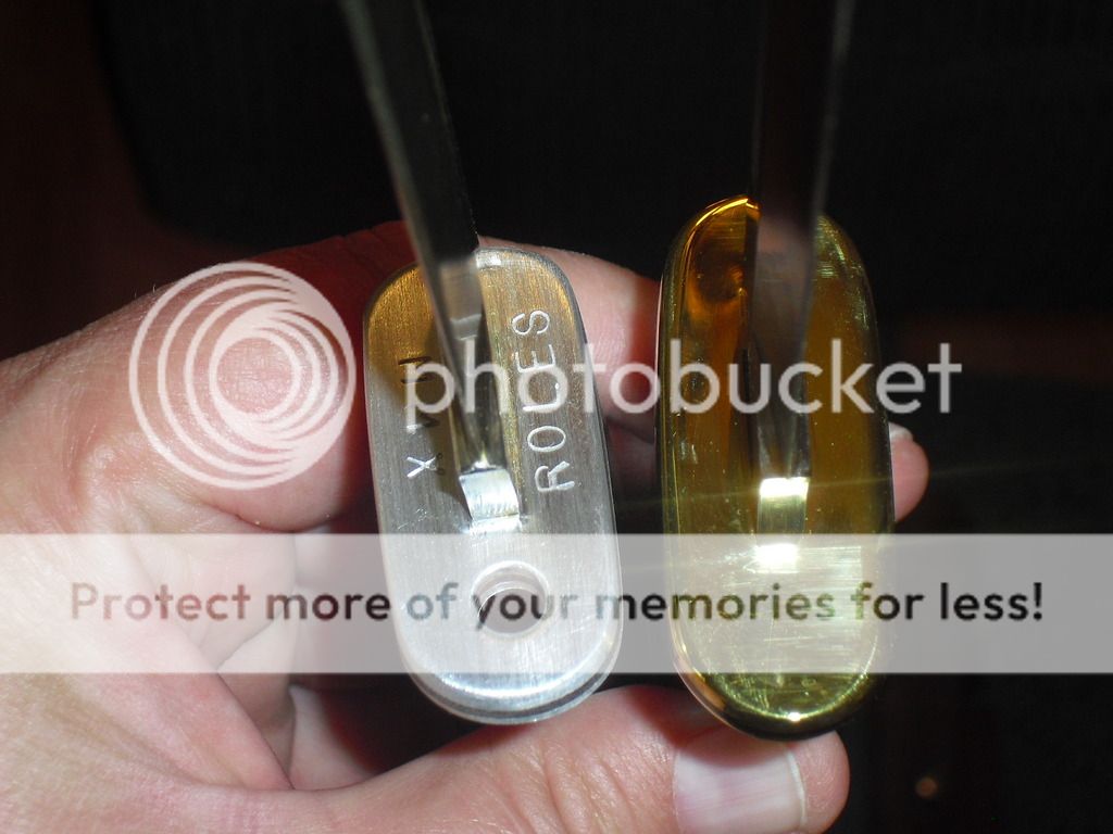

In the second pic, you can almost see the tang stamp. There is no year symbol; only
BUCK
119
U.S.A.

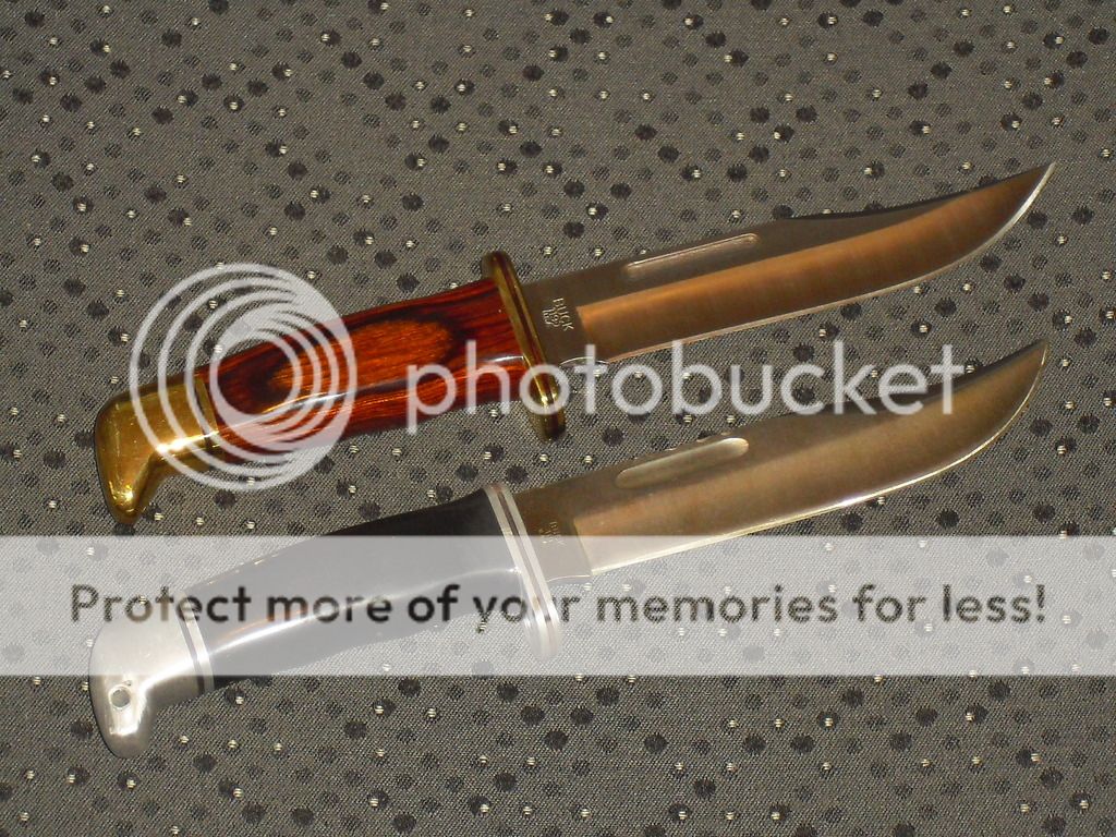

I have reshaped the handle a bit, and finished with 1000 grit wet dry. The original 119 handle is fairly thick at the guard, and tapers toward the pommel, and it is kinda blocky. I saw another 119 owner's mod to his handle and did that to mine, by thinning the handle thickness at the guard, and leaving the thickest part in the middle of the handle. Tho it is a subtle mod, it feels much better this way.

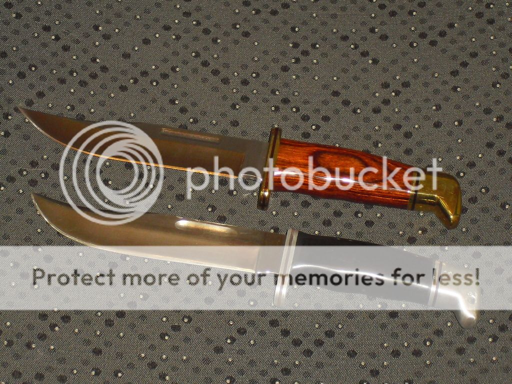

I am thinking about a mod to the tip. I recently got a Buck Custom 119 with their drop point blade, and may try to do something similar to my standard 119. Here are some pics to show what the difference is.
I decided to go ahead with the tip mod, and here are the pics. I removed metal down to the original blade flat, not quite as much as I had drawn on my schematic, yet I really like the resultant shape so stopped grinding. I also roughed up the handle with coarse sandpaper to give it a better grip when wet.
