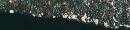

I have not found in my cutting tests that carbide-rich steels are better than carbon steels. The reason is that I have tested extremely sharp blades and in that case there is no room for carbides on the thin cutting edge. In the Figure 1. is shown a microscope image of exceptionally good group of carbides on the cutting edge, generally fewer or nil carbides can be found on very sharp edge.
Fig. 1. Microscope photo of carbides (white) on a cutting edge

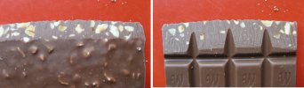

It is difficult to photograph the cutting edge because the shallow depth of field of light microscope. For that reason I have made for you a hazelnut chocolate demonstration, which clearly simulates the situation. My test equipments are shown in Figure 2.
Figure 2. Marabou hazelnut chocolate demonstration equipment.
Marabou hazelnut chocolate contains 17% nuts. If we think that chocolate is steel matrix and nuts are carbides, it simulates a carbide-rich steel. The chocolate plate can be sharpened by kitchen grater. So we can visualize the fact that, when a blade is sharpened very sharp, there is no many carbides on the cutting edge (Figure 3). Thus, the steel matrix will make the majority of the cutting work. In addition, the carbides on the thin edge are not surrounded at four sides by steel matrix and they may drop off.
Figure 3. Hazelnut chocolate cutting edge (chocolate is steel and nuts are carbides).
So, the hazelnut chocolate demonstration shows it clearly; when the target is ultimate sharpness, carbide-rich alloy steels are not necessarily better than plain carbon steels.

Very interesting. I can get a sharper edge faster on simple carbon steels such as 1070, 1095, 52100 than I can on high carbide steels such as D2 and S30V, but both can achieve mirror-smooth edges. At coarser levels (DMT red hone), the high carbide steels seem like they cut more aggressively. Some high carbide steels like CTS-XHP and S35Vn seem to fall in between; they will take a very fine edge with less time and effort.
I struggle with this issue. In a powder steel, the carbides run 2-4 microns. The edge of a very sharp knife is going to be 1 micron or less. I think straight razors get to 0.35 microns.
So, yes, there is not room on the apex for unsharpened carbides. But who says they are not sharpened? On a coarse steel like D2, the carbides can be 50 microns in size and clumpy, which means that almost any stone will tear out the carbides. So why does D2 steel hold an edge better than 1095? My thinking is that the carbides are sharpened along with the steel matrix. A hard Arkansas stone or an extra fine diamond stone will have a coarseness of 8-15 microns, which seems fine enough to hone the carbides without tearing them out of the matrix.
Also, the carbides on powder steels are fine and well distributed. A Norton 8000 water stone will have a grit at 4-8 microns, which is still the same size or slightly larger than the carbides in a powder steel. But if those stones are also sharpening the carbides, there can be less carbide tear out, especially when the carbides are fully surrounded by steel matrix and not clumped within the matrix, as we fine on super steels.
And we have lots of evidence that high-carbide steels out cut simple steels by a wide margin, including rope cutting, cardboard cutting and well-controlled, scientific CATRA tests. What besides the presence of carbides on the apex could explain that performance advantage over simple steels at the same sharpness?

In my chocolate demonstration nuts were sharpened. But the problem is that the cutting edge have more chocolate (steel) than nuts (carbides). In one dimensional line smaller amount of carbides can not prevent abrasive wear of larger amount of steel. But the situation is different with surfaces or slightly blunt edges; then the carbide particles can block the abrasive particles. In practice this means that a carbide-rich steel blade has fast initial wear, and after that, the wear stagnates and the blade can keep the serviceable sharpness for a long time. For that reason, I think, carbide-rich steels have great success in CATRA and field tests.

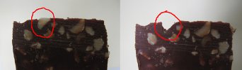

I have found with microscope that carbide pullout does not take place when a larger portion of the carbide is hidden than visible. Here is for you a carbide pullout simulation.karbide.jpg
If the edge apex is 1 micron and the carbide is 2 microns then the missing piece would be much smaller then the pic,but I agree that pullout will and does happen. Thanks for the excellent topic.another ? would the carbide be sharpened or would it be fractured?
Carbides will be sharpened just like nuts in chocolate. Carbides do not fracture easily because they are so small, but carbide steel interface fractures easily.

The chocolate visual really represents a steel with an extremely coarse carbide content, with carbides large and poorly distributed.
Like this D2 steel:
But the powder steels don't look like that. The photo below on the right shows a powder steel with the carbides being very small and well distributed.
