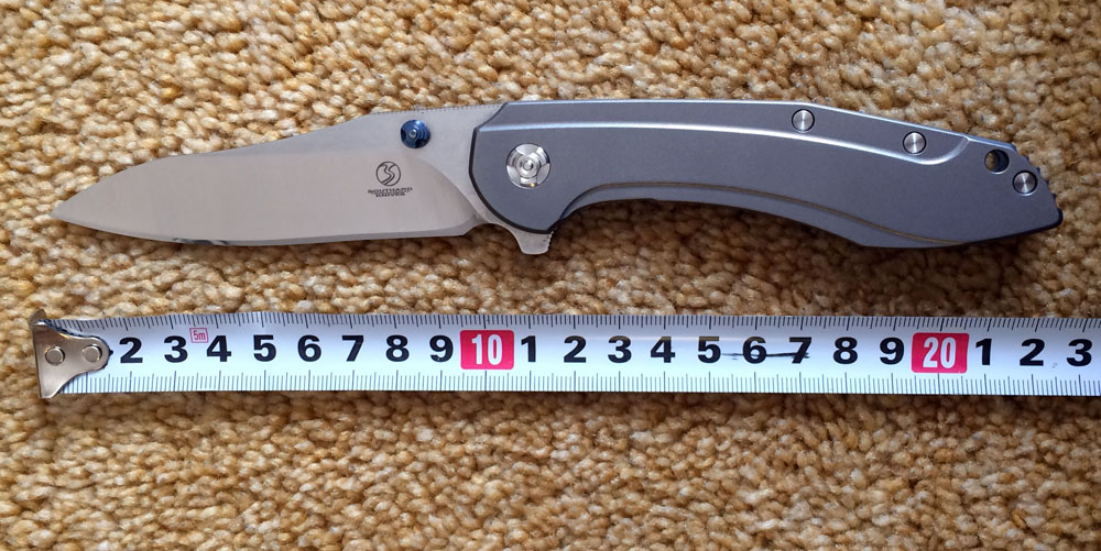

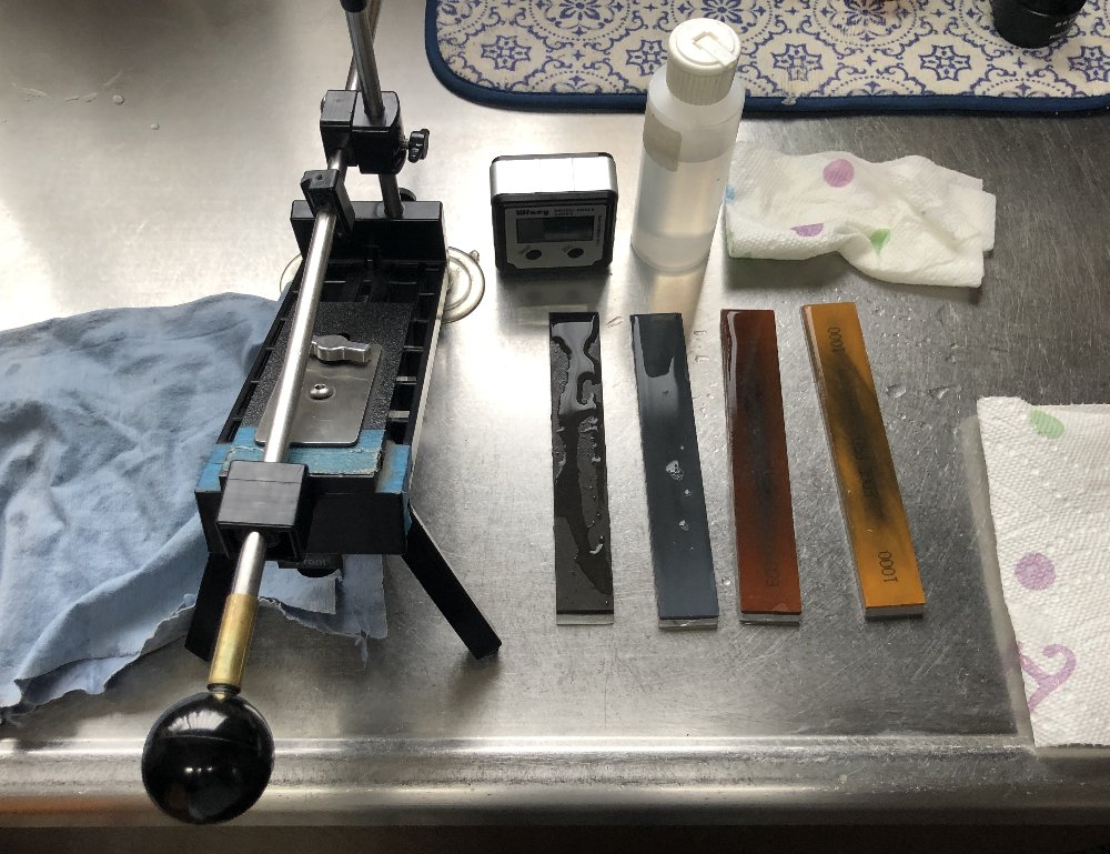

The knife: Baladeo slip joint knife, stainless steel blade
System used: Edge Pro Apex with a small-knife attachment and stage magnet
Stones used: Venev diamond #150, Congress Tools Moldmaster silicon carbide stone #400 mounted on stone blanks, Edge Pro aluminum oxide stones #600 and #1000, DMT Aligner EEF diamond stone
(I use double-sided tape to secure Moldmaster on blank. You can remove it by torching the blank or dipping them in boiling water)
Disclosure: In my regular sharpening, I use Venev diamond stone #150 and that alone, as I prefer a coarse toothy edge. Also, the fine aluminum oxide stones may not work for high alloy steels like S35VN, as carbides in these steels are harder than the abrasive. I would either stop at #400 or less, or use fine diamond stones for these steels.
Tips: If you use stones from different manufacturers, check and compare there grit rating systems. A finer stone from one source may have larger abbrasives than a coarser stone from another vendor (thanks jjg6319 jjg6319 !).

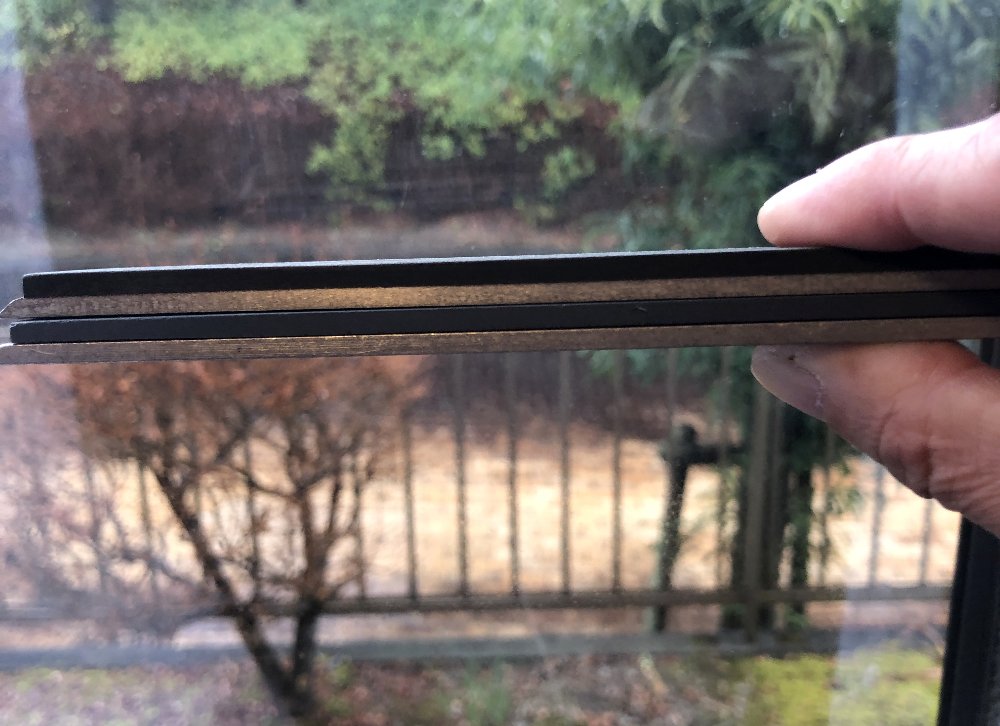

1. Inspect the stones
Make sure that all stones are reasonably flat by laying them on a flat surface and inspecting light penetration through the gap.
Tips: If they are not flat, you can flat them using Edge Pro stone leveling kit or similar DIY bits. For Moldmaster, I just replace them with new ones, since they are cheap. Moldmaster stones may not come super flat (thanks jjg6319 jjg6319 !).
Lesson learned: Edge Pro #120 silicon carbide stone dishes fast. If you use dished stones, you know what happens......
2. Soak stones in soapy water
Tips: Some stones like the Moldmaster stones need soaking. But some others like Venev and Edge Pro stones not so much.

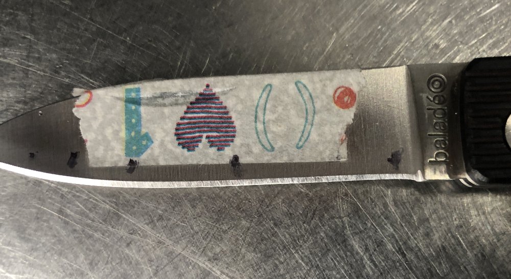

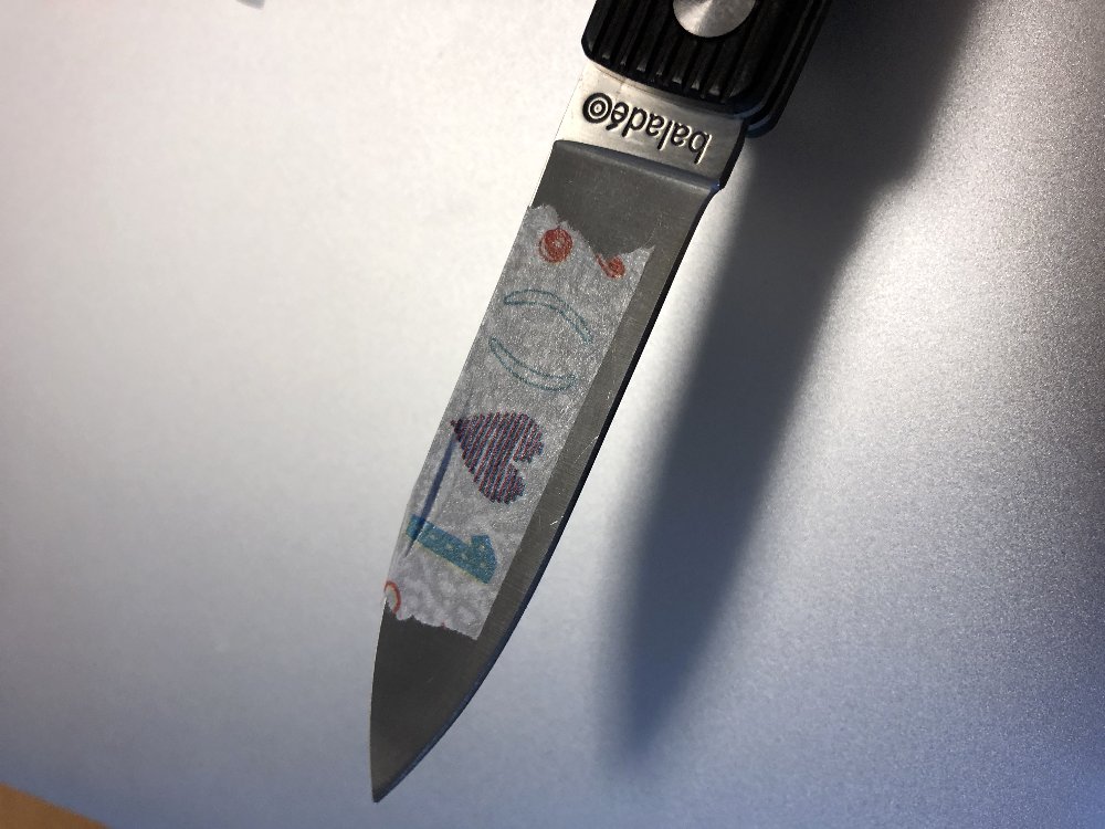

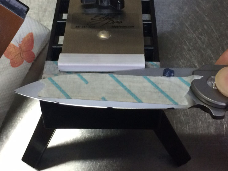

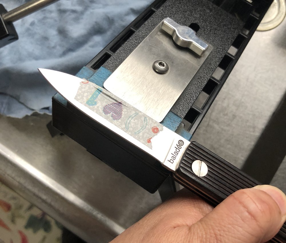

3. Protect the blade with masking tape
Tips: Use good masking tape. Cheap ones leave some residues. It is a good idea to tape the table as well. The one used in the above picture was a crappy one. Ready Post clear packing tape of USPS was recommended by a member (see a post below).
Lesson learned: If you don't do this, you will have scratches on your beautiful blade!
This carbon steel blade gets patina, so I did not care.....
4. Adjust the blade table
In this example, I used the small blade attachment.
Tips: Find a position where the knife is stable. Make the edge sticking out enough of the table.
Lesson learned: There was a point where the edge was shy of the table, and stones grind the table instead of the edge, resulting in a weird edge line. Make sure the entire edge is sticking out of the table!

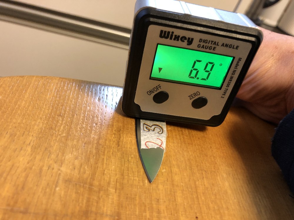

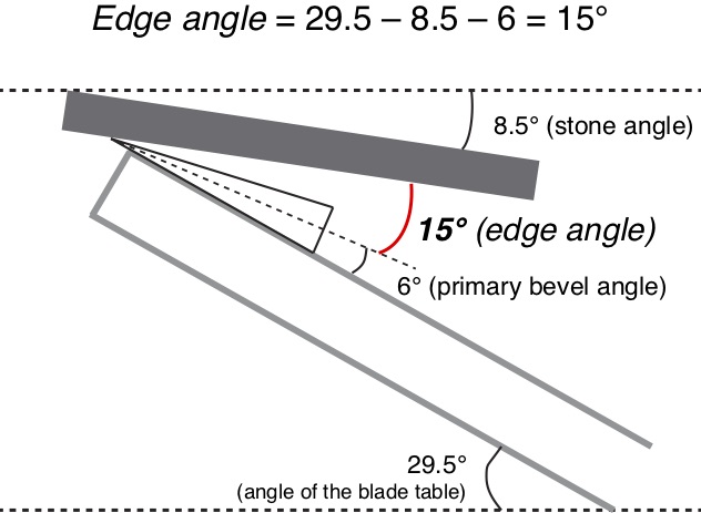

5. Measure the angle of the primary grind
Lay the blade on a flat surface and put an angle cube on the blade.
(This shown number is off because the table was not flat. It was actually 6.6 degree)
The angle is inclusive, and half of it is the primary bevel angle, which is gonna be used in the next step.

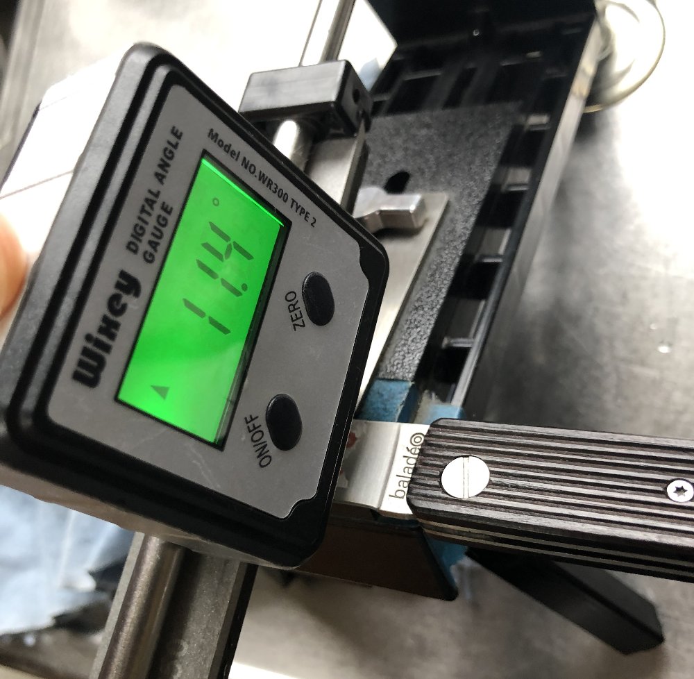

6. Set the stone angle
Put the coarsest stone on the blade, and measure the angle using an angle cube.
Keep the number somewhere, as this is the angle you keep for all stones.
The edge angle is calculated as follows.
My Edge Pro has the stage angle of 29.5 degree. Yours may be different.
So, for this blade (3.3 primary grind angle), if I want the edge angle to be 15 DPS, I need to set the stone angle to 11.2 degree (29.5-15-3.3).
Keep the number somewhere for future sharpening (I keep them in a text file, thanks M maximus83 !).
Tips: In this example, I sharpened at 15 DPS to amplify edge inconsistencies. But I do recommend to sharpen at the factory angle. To do so, paint the entire edge bevel with Sharpie (or several lines across the edge bevel at a few places). Attach a fine stone like #600 and set the arm angle at 18 degree on Edge Pro. Swipe the edge lightly and see how much Sharpie is taken off. If it is wiped for the entire edge bevel to the apex for most part, that is the factory angle. If not, put Sharpie again and find a setting to wipe it off. Then, measure the stone angle with an angle cube. Use that angle for all stones. You can also calculate the factory angle as the above illustration.
(A few more tips for the sharpening angle are available below)
Lesson learned: I just used the angle setting of Edge Pro. I realized that some stones do not reach the apex because they are thicker than the others! So, I tried an adjustment collar, and that failed. Angle cube is much better and consistent.

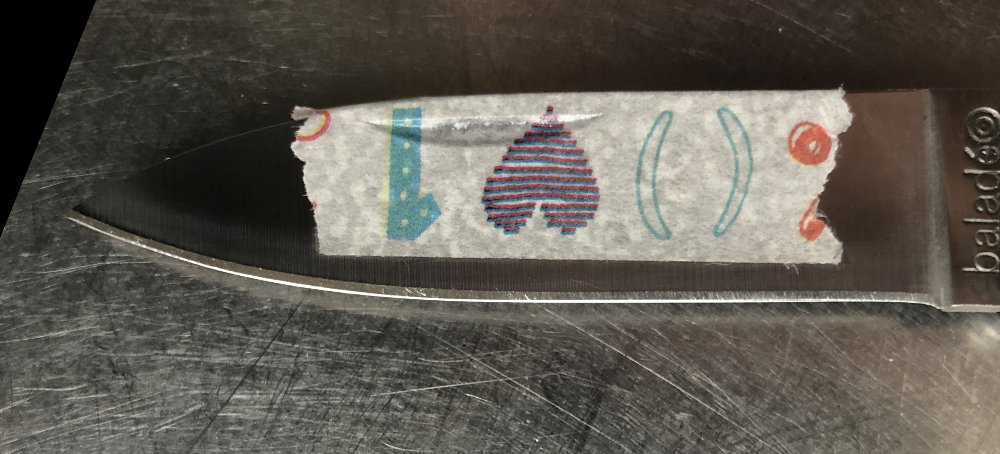

8. Initial grinding with the coarsest stone
I use back and forth motions to remove some metal from one side of the blade, probably like 10 strokes.
Just a tiny bit of pressure to the blade, in addition to the weight of the stone and the handle.
After 10 or so strokes, I check how far the scratches away from the edge.
If they are too far, I do 10 more strokes and check the scratches again.
As you proceed, you would notice areas where scratches are farther away from the edge than other areas.
Typically, you would have under-ground areas near the tip and heel (see 10).
Tips: Make sure that the stone grinds the heel area sufficiently. Do not drop the stone off the tip. This will round the tip. Stop the stone when the tip reaches the midline of the stone. Use light reflection or a loupe to spot these problem areas. Do not grind too much at this point. I would not let the stone to touch the edge yet.
Lesson learned: I have rounded the tips of many blades.....

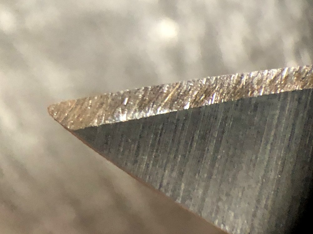

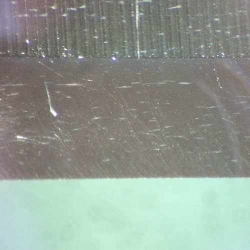

10. Aligning the scratch pattern
Now you know which areas need more attention.
So focus on these areas to grind with the coarsest stone.
The goal here is to make the scratches away the same distance from the edge.
(What's visible here are the micro bevel, original edge bevel, and new scratches by the #150 stone from left to right)

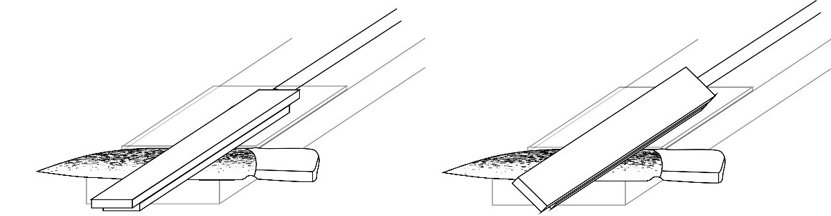

Tips: These areas can be quite small. In that case, I use a corner of the stone to grind specific spots. When you have a sopt near the tip, use very short motions to grind and avoid rounding the tip.
This is somewhat typical. You can see that the stone already grinds the tip but not the apex anywhere else.
Also, you tend to have issues near the heel. Again, use a corner of the stone. Sometimes you have to remove some materials off from the choil or ricasso. Below shows how I do it.
Left, the entire width of the stone grinds the blade. Right, by tilting the stone, one corner or edge of the stone grinds the blade. You can grind a small area this way. Sorry for the bad illustrations!

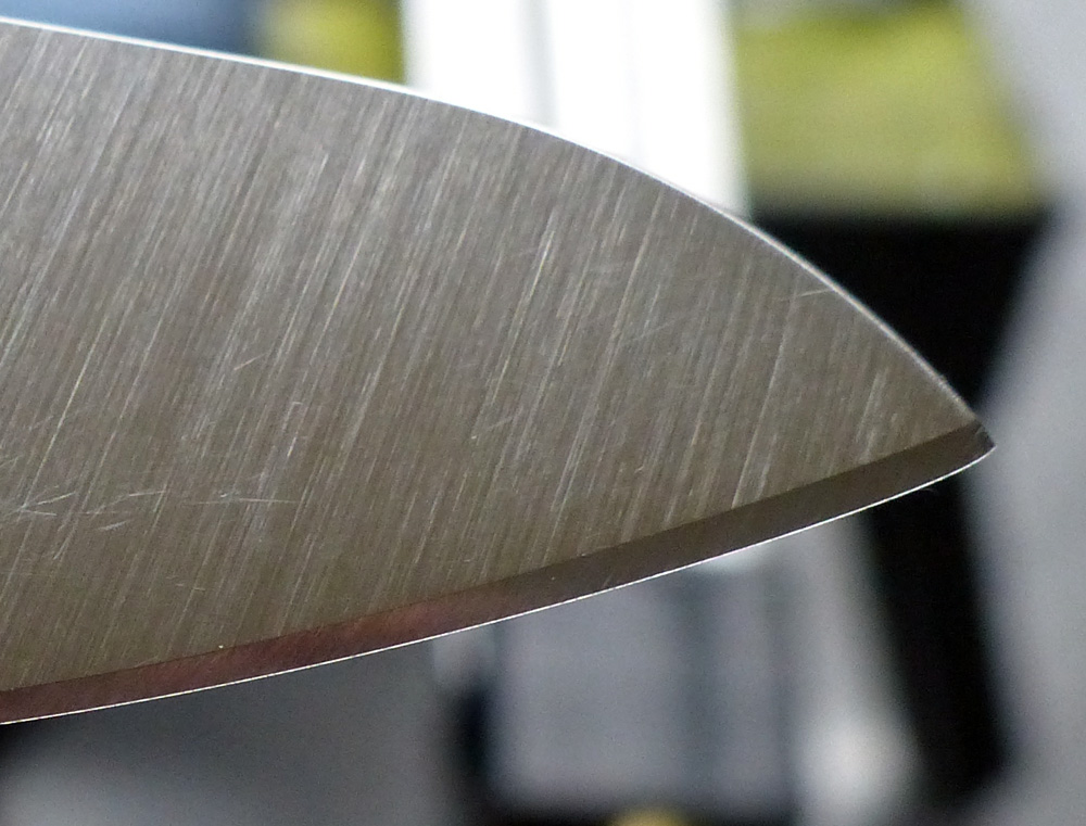

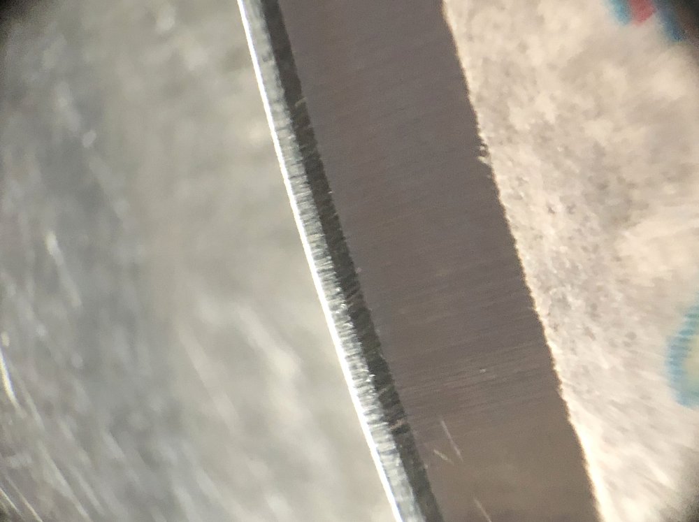

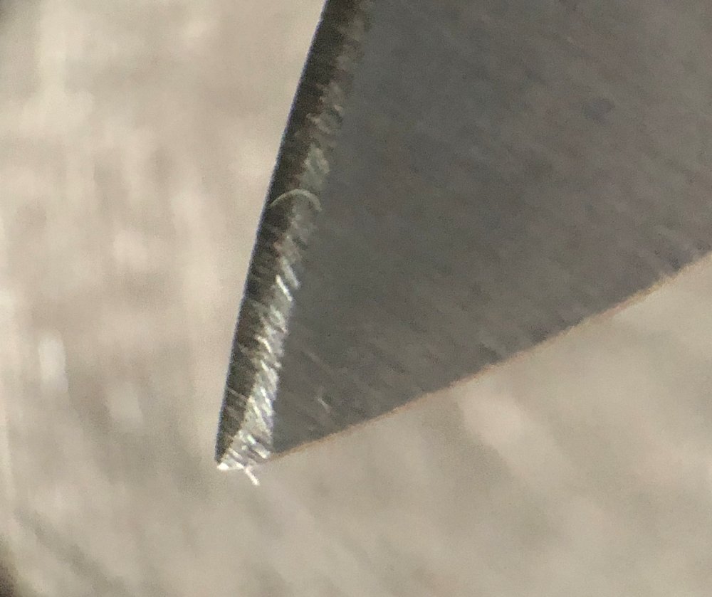

11. Raising a burr
Once the scratches are somewhat aligned in most parts, perform back-and-forth grinding from heel to tip to raise a full-length burr.
With a coarse stone, you can easily feel the burr with you nail or on the fingerprint.
It may even be visible (on another knife, another day).
You can also check if the stone grinds all the way to the edge using a loupe.
Tips: I normally stop at this grit. To make the edge more aesthetically pleasing, I perform full-length single strokes from heel to tips about 10 times. This makes a nice uniform scratch pattern.
Lesson learned: A few times, I did not check the edge and failed to raise a burr at the tip. I realized after cleaning up everything and had to set the system back again.....

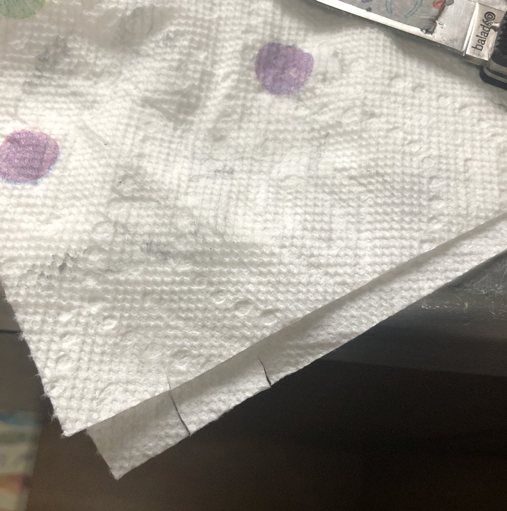

13. Burr removal
Once you raise a burr on the other side, you should deburr the edge.
I flip to the side I start with, on which the burr is now hanging, and run the stone from heel to tip in one single motion with just the weight of the stone and the Edge Pro arm.
You can feel the stone grind the burr off.
Then five more very light strokes.
Flip the blade and two light full-length strokes from heel to tip.
Flip again and a single stroke.
Flip and a single stroke.
Flip and the final single stroke.
After this, the blade should cut paper towel cleanly.
Lesson learned: I did not deburr and just proceeded to a next grit. Ended up with a lingering burr raised by the coarsest stone after the finest stone. Not sharp at all!

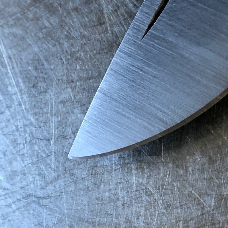

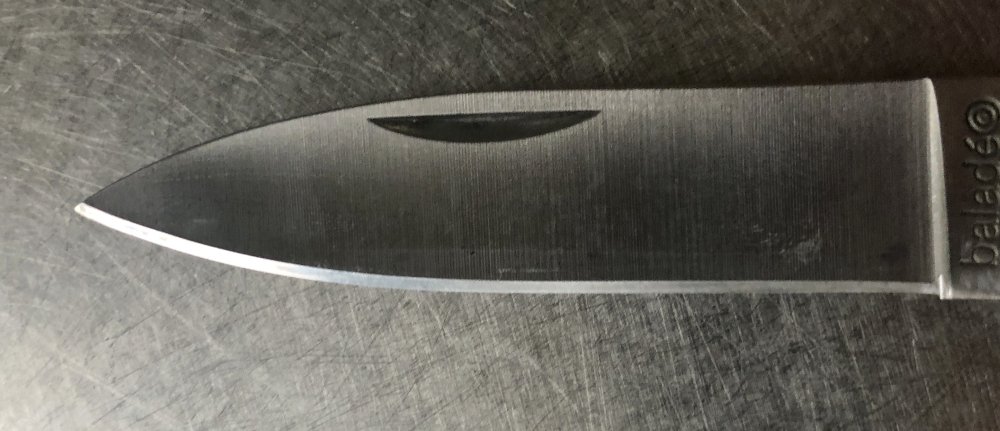

For knives with insufficient sharpening choil or without it
For these knives, sharpening near the ricasso might be difficult. Spyderco knives without choil tend to have a "bump" in front of ricasso, which makes the heel hard to reach. I just remove the bump using a corner of a coarse stone first. Also, a stone might hit and ride the ricasso for some knives with insufficient choil. This may cause over-grinding of the area in front of the heel, as a corner of the stone grind more from that area. I made a few knives "recurve" that way.
Original with a continuous curvature. This knife has an insufficient sharpening choil.
After "bad" sharpening.
(You can see that the area below the logo became recurved, as the stone rode on ricasso and its corner ground the area more....)
The area near the heel is not sharp

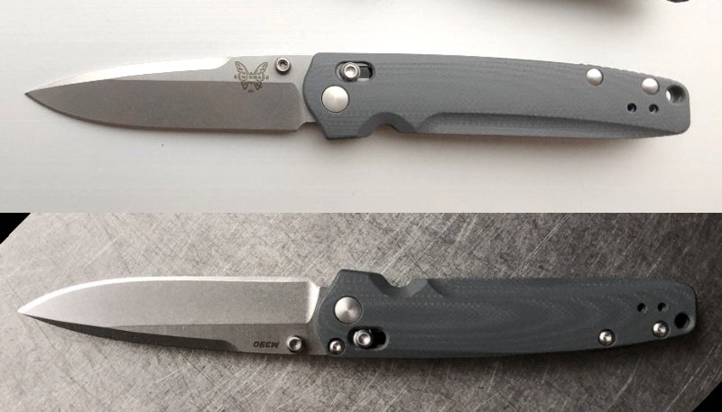

Edge bevel became too wide after reprofiling
Most factory knives have edge angles like 18~21 DPS. Some of them may seem to have very small edge bevels and to be thin behind the edge bevel. But it is probably because the edge angle is quite obtuse. So, if you reprofile them to a much lower angle like 15 DPS, you will end up with a much wider edge bevel than the original.
(The original narrow bevel (top) was much widened after reprofile (bottom))
The blade shape is somewhat different after reprofiling
If you reprofile a typical factory edge to 15 DPS, you will need to remove a lot of material. When you remove a lot of metal at once, you tend to remove them from certain spots nonuniformly rather than from the entire edge uniformly. This is due to uneven factory bevels as shown above. If you use a fast-cutting stone, when you notice that unevenness, it may be too late, and the edge line is already deformed. So I do not recommend to reduce the edge angle too much in one single sharpening session. It it better to do that over a few sessions, for example 20 DPS at first, 18 DPS at second, and 15 DPS at third.
The edge bevel is wider on one side than the other
It is typical to have uneven primary bevel on factory knives and therefore to end up with uneven edge bevel width. For the uneven edge bevel, you have two options. One, you can sharpen the narrower side more than the other intentionally in future sharpening sessions, and the difference is going to be corrected over time. Do not try to correct the difference in one single sharpening session! Two, you can sharpen at different angles to match the bevel width.

- In step #6, not sure if it's just me but it looks like one image is missing/broken, where you calculate the angle.
- In terms of 'repeatability', thinking about how to sharpen a knife on your EP the next time you sharpen it (I mean actually sharpening/resetting the edge, versus just refreshing the micro-bevels on EEF): Are you doing anything such as writing down details about a knife, what angles and settings you used, or where/how you positioned on the table? Wondering if that is worth doing or unnecessary. I noticed that some of the competition, such as W.E., are providing tools for people to ensure repeatability in subsequent sharpenings. But maybe the delta would be so small it doesn't matter.
Execellent tutorial. This explains some of the issues I've been having. My question is can you explain how you got to the 11.2 degree angle for the 15dps? Thanks
Yep.
The image link was missing.
I fixed it and hope that now the calculation makes sense.

I have tried putting tape with compounds on a stone blank, but not directly on the blank.
I have been thinking of taping a piece of glass of a blank and apply diamond suspension.

EP has blank for polishing tapes to give you the additional height to be similar to the stone heights:
https://www.edgeproinc.com/sharpening-accessories/polish-tapes-blanks/polish-tape-blank-p28.html
I was not sure from your above response if you were aware of that.
I tested them and and diamond lapping films.
I even applied diamond suspension to a worn polish tape.
They work some extent, but I did not like the result very much.
It’s probably just me.

miso2 miso2 , another item helpful in your write-up was some of your close-up photos. I know from having done a fair amount of photos for my own posts, it can be tricky getting a quality close-up of a knife blade that shows the nuanced edge details, but without being either too dark, or showing excessive glare or reflection. Sometimes I can get mine to come out the way I want using my phone cam on the macro setting, but it's a crap shoot. A couple of your close-up photos turned out pretty nice and show lots of detail (and a couple turned out kinda' blurry too, which MOST of my edge pics do and I have to discard 3 or 4 bad pics for every good one :eek:). For example your 2nd photo in step 3, the first one in step 7, and a couple of those in step 11.
What basic setup and approach were you using to get the close-ups that turned out well?
The ones you mentioned were taken with my phone.
I tend to get good ones when I have good secondary sunlight, good blade angle, and good focusing.
I have also tried burst shots and image averaging, which worked fine.
I got lazy this time and just used a loupe in front of my phone.
That is why some photos are blurry.
Edit: Oh, also I fix the focus and move the phone/camera to get the perfect focus.
