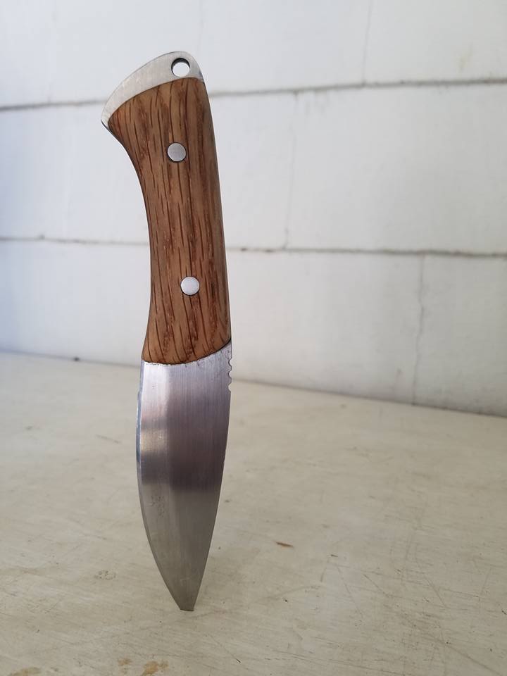

Very good job!
Clean, neat, no extra things that aren't needed, and a slight curve to the whole thing. Jimping is minimal and simple.
Only thing I would suggest is having a little ricasso on the next one. As your blade is, the edge goes all the way to the handle. This places your index finger at the junction of the two with no unsharpened ar4ea to divide them. One slip or misplacement of the hand and you have a cut finger. What I would do on your knife is add a 1/8" to 3/16" choil on the edge just at the handle. It will be a small semicircle indent with one side at the handle junction. Use a small cylinder burr stone ( chain saw sharpening stone) in a Dremel, or file it in with a chain saw file (it will dull the file, but should be able to file down the hard edge steel). I like a small choil on most field type knives. It looks good and aids in sharpening.
