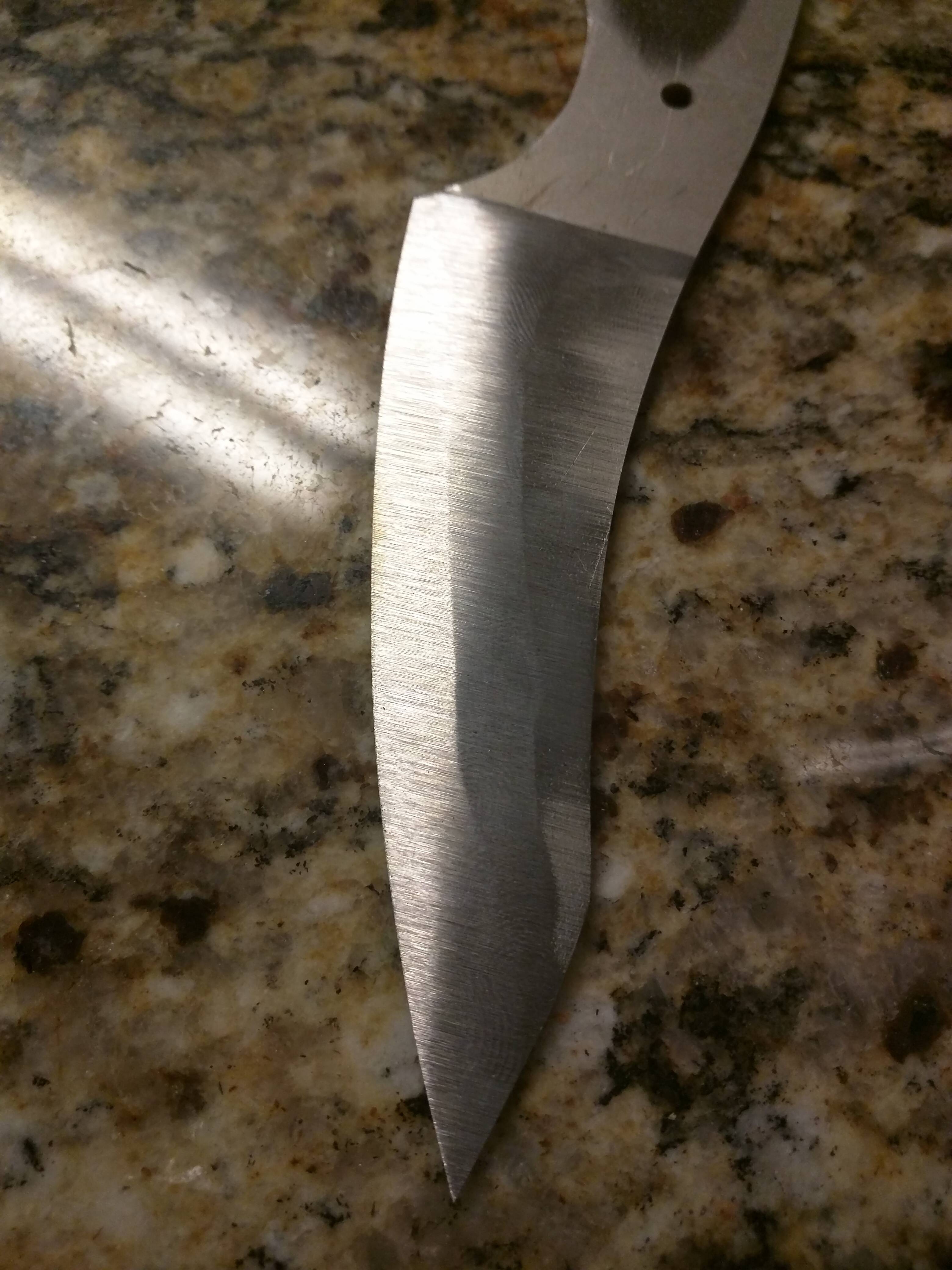

I appreciate all the advice guys. I'm trying another one now. No screw ups yet, but it does feel craaaazy slow! I'm using an 80 grit ceramic.. Some passes get hot enough I have to quit pressing with my other thumb, yet you can't even hardly see any change to the bevel!
Quick update. My right hand is better than my left. Slowly worked the grind up one side and looked almost exactly like I wanted. Switched to left hand.. Grind line kept looking like a two year old drew it. As I got near the right grind height but still uneven, I accidentally tilted the spine into the belt. I rage quit and tossed the knife across my workbench. :|
Some great advice that I've read many times here is to grind the bevel on your off hand side first, then when you get something you're "happy" with, match it with your good side. Also don't worry, this is extremely common and it's just something that comes with practice. It's the same as learning to play any instrument that uses both hands equally, you know, like when you first pick up a guitar and you feel almost paralyzed with your non dominant hand? ;)
A big part of grinding in general is learning how to adjust and fix your screw ups as you go. Also, proper grinding stance is very important and takes a lot of variables out of the equation, such as tucking your elbows into your waist so they don't move, locking your wrists into a fixed position and doing almost all of the grinding motion by shifting your weight between your legs along with a little bit of waist movement ("twisting") as well. Essentially you are trying to use your whole body as if you were one big fixture/jig that doesn't wobble this or that way etc.
And FWIW, that bevel still has plenty of room to be fixed up. Just get it flat and then raise the good side to match it. It's very hard (as least it was for me) when starting out to grind short height bevels, especially on thinner stock. Try not to focus too much on getting the height of the grind just right and instead try to get them flat and even without cutting into the spine in the plunge. Hope some of this info helps :)

And don't forget that you can always grind the flats of the blade (vertically on the platen using a strong magnet) by taking a bit of the blade thickness down to help clean up the top of your grind lines. The picture you just showed above is a perfect example of when cleaning up the flats comes in handy. A lot of guys do this, and no, it's not "cheating", in case somebody were to think that for some reason lol. :D
