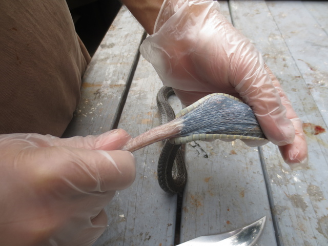

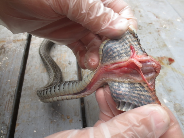

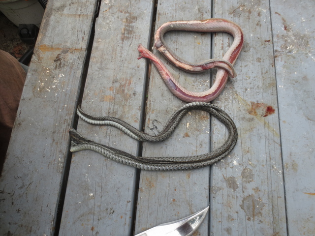

**Skinning method 1: For inverting the skin, start at the former location of the head. Using your fingers, work the skin off of the meaty part of the snake. Start at the belly where the skin is easier to remove ( the skin around the spine is harder to peal away ). Take your time and work about the first 4 to 6 inches of skin loose. Pull the skin over itself, then grab the meaty part of the snake with one hand and pull the skin down with the other. Continue pulling until you get close to the end of the snake. Cut off just before the vent of the snake and dispose of the tail ( yes, snakes have tails ). Proceed to pull the skin complete off now.

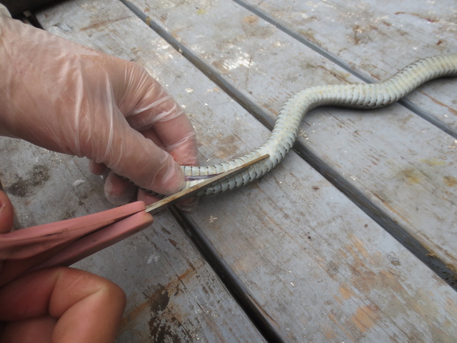

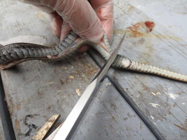

**Skinning method 2: If you are going to cut the belly of the snake ( I recommend this method, you can do more with the skin this way ), use scissors instead of a knife. I have used a knife several times but you can never keep it centered on the crawlers ( the belly scales ). So use scissors and start at the former location of the head. Start cutting and keep it centered. Just before you get to the vent, cut off the tail and then finish cutting. Go back up to where you started cutting and begin pealing off the skin. You may peal some meat off the skin, this is ok because you will scrape it off later.

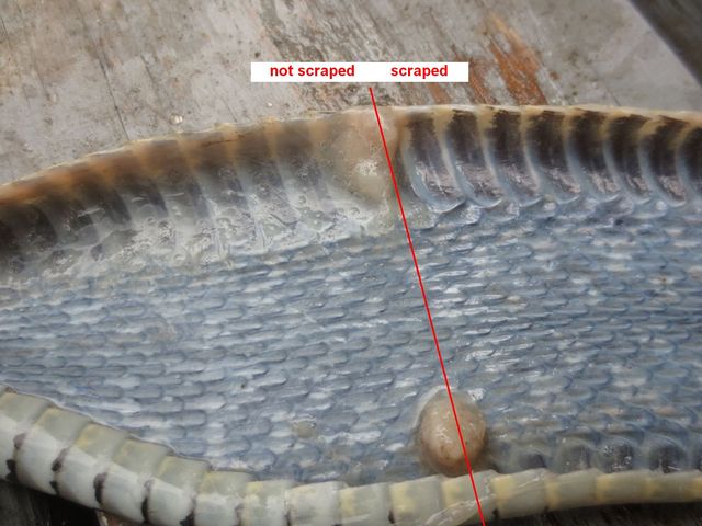

**Once the skin is removed, you will need to scrape it. Scraping the skin removes a thin film of muscular tissue that prevents the tanning solution from soaking through. This is the step that most people either skip or dont do a good job at. Not removing this tissue layer will have adverse affects in the tanning process and the final product. So take the time and do it right.
**Begin by laying the skin on a tables edge or the edge or anything. Use a knife and just scrape off the tissue layer. It should be a clear or milky and very slick film. It will be a pain at first, but take your time and try not to cut the skin. And you should be scraping, not cutting, the knife should be 90 degrees to the skin. Remove as much tissue as possible. Once that is done, wash rinse the skin in water ( not hot water and no chemicals in the water ).

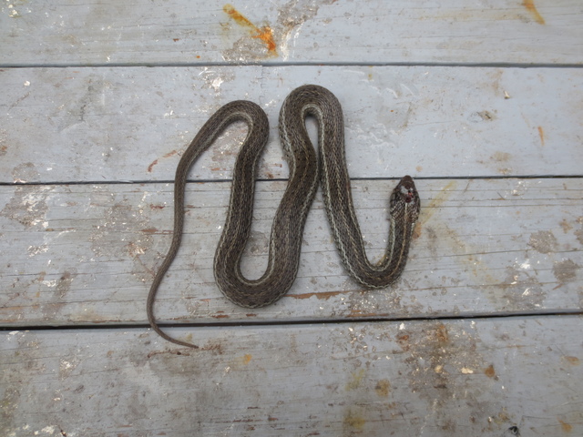

Garden snake I had in my bard threatening my chickens and eggs.
Cutting down the belly with scissors.
Cutting off just before the vent.
Separating skin from meat starting at the former location of the head.
Pulling skin off.
Separated.

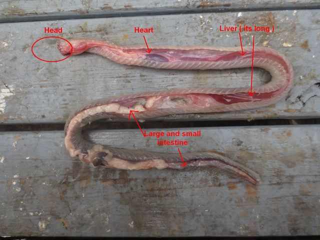

Snake anatomy.
Skin scraping.
