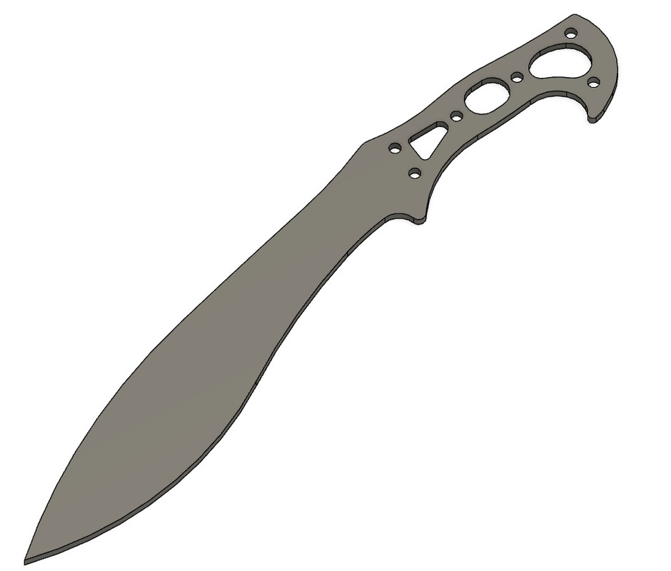

11 1/2" blade, 17 3/4" overall. 3/16" stock. No name yet, though "Barkukri" was suggested, since it is a hybrid of the bird's beak barong style handle, with the khukuri blade shape. Not necessarily feeling that name, but the design suggestion was brilliant, and this is what I came up with.
Looks like an exceptionally good design,

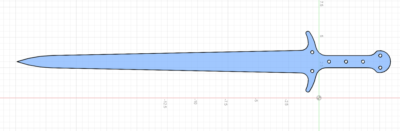

Request for a Modern Tactical Sting. 19" blade, 26" overall. 1/8" stock so it's manageable for fast cuts with its over 2" wide blade. Design as it looks so far. Though seeing the CAD file extruded I am starting to think maybe 5/32, or even 3/16"........ activate mulling mode
How do you make that design without a metal pommel of some sort
The pommel is oversized compared to the original piece from which this one has drawn its inspiration. The scales will be a lighter material like wood or micarta using the first four pin holes, and something heavier like G10, or more likely Suretouch on the pommel. It will also swell at the pommel so that the handle is thinner and the pommel is a bit more globe like. This will act to create the balance characteristics of a smaller metal pommel, while also making for a more mechanically secure grip on the handle.

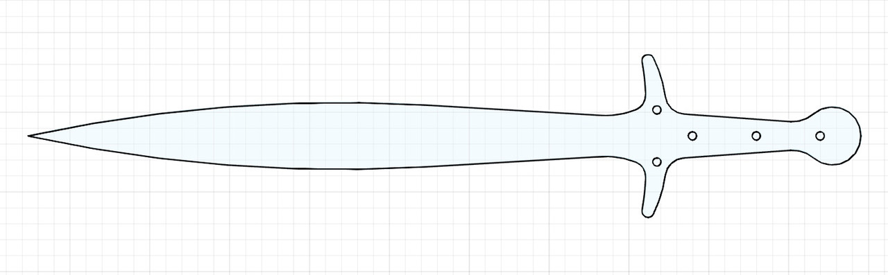

Another idea for a Western European inspired short sword. 24" blade, 30" overall. This is just something I would like to do. I may or may not.
You know, another 5-6" on the blade and you could make a proper Viking age sword. Single edge for me, please.
