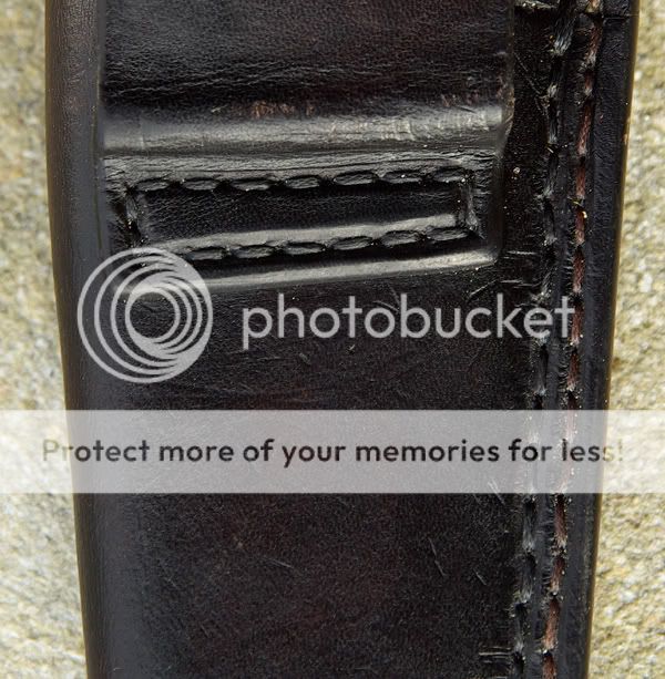

The leather is half-tanned, 3mm ( 0.12") thick.
I got the dye from my leathersupplier(http://www.nordellknives.com/indexx.shtml)
After that I waxed the sheath with sno-seal, which is mainly beeswax. I put the sheath in the oven at around 90 C ( 176 F) and see the wax getting soaked up. I repeat that till the leather is saturated.
Great thing about sno-seal is that the leather keeps it's shape and doesn't get sloppy.
Because it has a liner the leather is waxed on the inside too. It's very weatherproof after this treatment, and it doesn't get soaking wet anymore, and dries up quickly.
