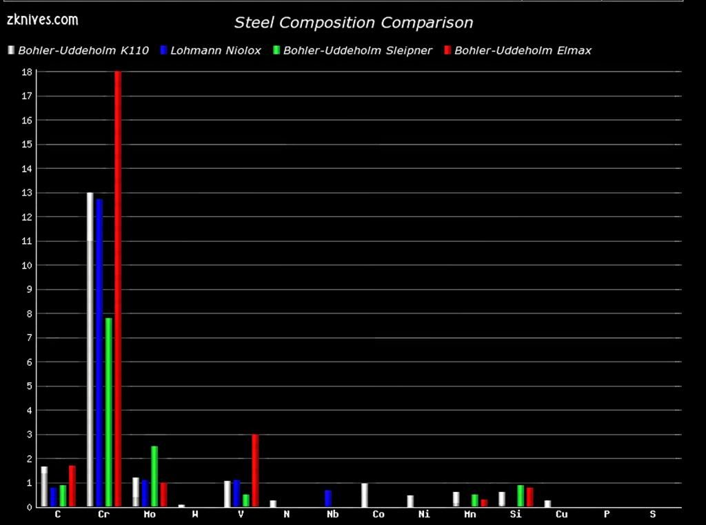

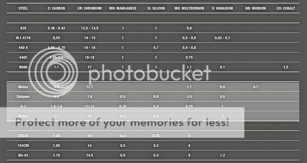

LionSteel 2014 Catalog page 24:
Composition Comparison Graph For The Knife Steels Bohler-Uddeholm K110 (D2), Lohmann Niolox, Bohler-Uddeholm Sleipner, Bohler-Uddeholm Elmax

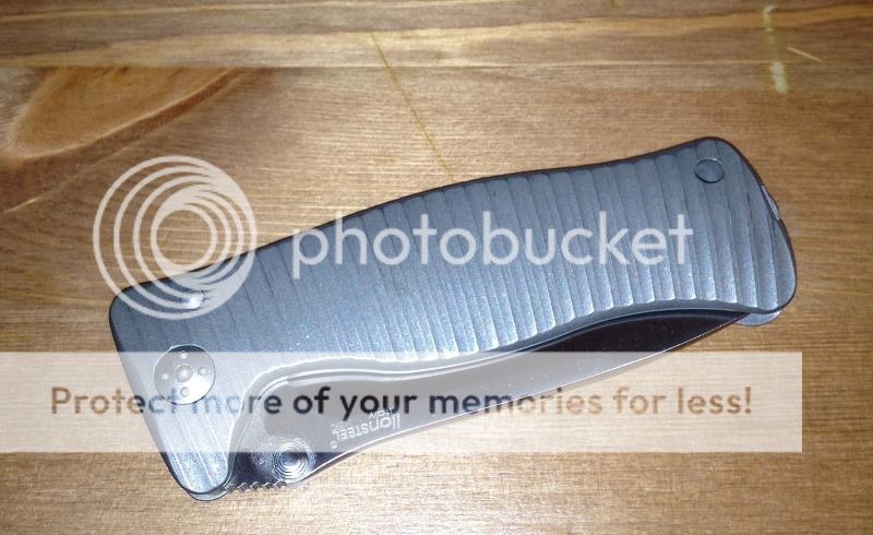

M390 was tried for SR-1. In test Sleipner have better edge retention.
Here a picture of m390 sr-1 used for test. Read under lionsteel.
Molletta,
Can you please tell us about the edge retention tests you conducted which led LionSteel to pick Sleipner over M390 for SR-1 a few years ago.
Sleipner have secondary hardening and in Sio2 test have results near Vanadis 4. 10mg/min circa. M390 can be tempered to obtain secondary hardening, in this case has similar values ​​of consumption, but it's usually tempered to obtain better corrosion resitence an so wear is lower.
Although the M390 appears as part of one of the finest stainless steel, the comparison with the carbon steels and something different. Carbon steels have the particularity to cut even when apparently they have edge consumed. In a practical test, repeated to obtain reliable data, the SR-1 sleipner cut long even in the latter part of the test was necessary to press. The one in the M390 cut fine but at some point there was a rapid decay until a cut.
In a test on vanadis 23 with a specific heat treating , we could not finish it.

Anyway, back to wear resistance test, you mentioned Sleipner was very close to Vanadis 4, and that'd be one of the major surprises to me at least, based on Sleipner vs. Vanadis 4 composition comparison, both alloys have pretty much the same amount of Chromium, 0.20% is rather margin of error, and then Vanadis 4 has ~67% more carbon and 700% more Vanadium, which in the end amounts to very little difference in alloy performance? I doubt +extra molly and Silicon in Sleipner can explain the results either.
That was on SiO2 test? How is that happening, I can't attribute the result to stainless vs. non stainless, Cr is the same, what gives?
