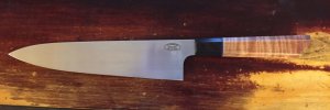

Not fabulous. A little wobbly but not bad for a first attempt. The curvature of the bottom makes it a bit tougher. You can't just throw it up against the fence on the router table. I did not dye the maple because I wanted to see how multiple applications of the red oil would work. Not bad, but I am still trying to figure out how it got this gorgeous orangey color once a few years ago in a sample block. It was almost like what you would get from Japanese lacquer.
View attachment 724290View attachment 724291
Wow that came out gorgeous! Would've been sad to lose the Brazilian rosewood if something had gone awry...
Did you make the finishing oil by soaking red alkanet root in it? Do you think you could get similar contrast with staining then oiling after the stain dried?

No, I still have a little bit of oil and the polishing compound from the Warthog kit from South Africa that I bought from Brownells a few years back. Unfortunately neither it nor the Purdey style kit are sold in the US anymore and the one similar kit still made in the UK can't be shipped to the US for some reason.
As for the knife, it is going be a gift, because has some little flaws in the handle. Good learning experience, though.
