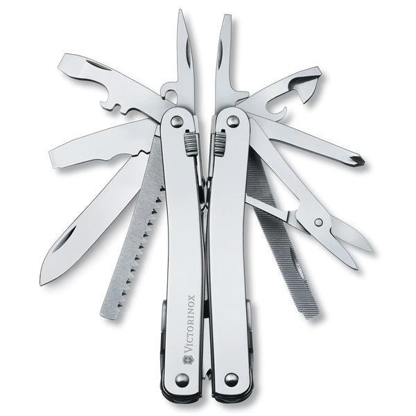

The Spirit X has one multi-purpose tool with several different sharpened edges: A chisel at the tip, a V-shaped and U-shaped notch on the side. Very useful for stripping varying sizes of wire and cable. It's the one at 9:00 in this pic:
All tools (except the pliers) are accessible from the outside and all lock.
