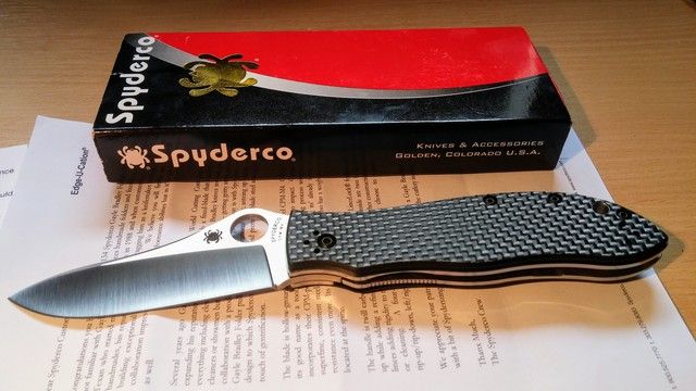

So I bought a Gayle Bradley 1 and it is a terrific knife indeed!
Let's start with some pics:
As we all know, closing the knife is hard to do and gives you a sore thumb pretty soon.
I solved this in a very easy way. Dissamble the knife and just bend the lockbar a little bit back to decrease the lockbar tension. Carefull, that needs some force! And just 1 mm will do. Measuring helps.

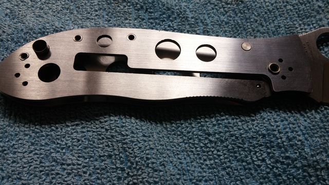

Also sandpaper and polish the sharp edges on the liners, especially the area where your thumb goes.
I also polished the washers, the inside of the liners and the pivot hole area on the tang.

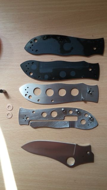

Some pics of the GB1 dissambled:
I can play with my GB1 for hours now. It became very smooth and a breeze to close! A mod which is very easy.

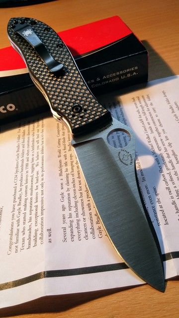

The GB1 certainly lives up to the hype and then some! It became my favorite knife in a very short time.
One for the road, thanks for watching:

Back to the dissambly: all parts fit extremely well, so it is a little bit hard to separate everything once the torx screws are out. The fittings are really exceptional! Very tight, yet easy to reassemble again without any problems. And as you can see on the pics, even the shoulders of the pillars are D-shaped. Perfection all the way!

Maybe you understood me wrong. Only thing I did was decrease the lockbar tension a bit a polish the sharp edges.
I can't see this affects mister Bradley's philosophy behind this knife.... Accidental side, twisting-type disengage is still impossible, as the knife was meant to be. But YMMV!
