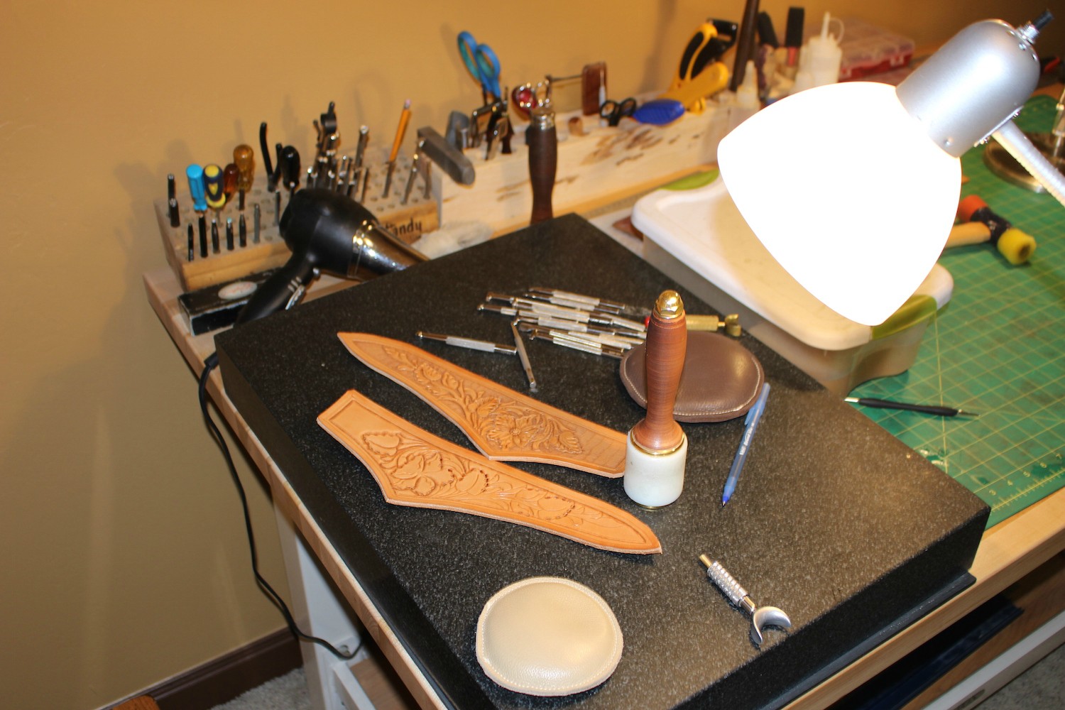

Here's Nichole's BK. She was flower carving these chink tops for me. Her chunk of granite is 18" x 24" x 3". Weighs 200 lbs. Sometimes if I'm good I get to come into her office and use "The Rock"
Alright Dave, I placed an order for the BK 16oz round maul.
I figure even though it's lighter than I'd have thought to buy, if you and the misses give it the seal of approval, it's good enough for me. It was a hard(ish) decision between tapered or not. My thinking is that I'd buy tapered if I tooled with the work a little closer to me than I typically do, but I'm so dang tall it's always a bit far away until I can set up a nice tall table. Honestly I have no idea what advantage one has over the other. It would be nice if leather & tool supply companies (across the board) wouldn't assume we know the difference. It seems to be a theme, which is frustrating when you want the best, but don't necessarily know what the best for you is.
Anyway, as is my way, I'll post pics and thoughts when it arrives. Now I need to start looking at stamps... Got me a jug of that pro carv a while back and want to try it!

As a woodworker I do know why a tapered maul or carving mallet as a wood carver calls it is tapered. The degree of taper is related to the distance from the elbow to the center of mass of the maul. If the swing of the maul rotates about the elbow joint, the degree of taper of the maul makes for a more comfortable swing and the maul strikes the stamp or wood chisel squarely. I've made a few of my own carving mallets for the wood shop from hard maple, turned on the lathe and they work fine, wood on wood like y'all mentioned.
If your work bench is too low for your stature, or if your swing while you're working doesn't rotate about the elbow joint, say perhaps your swing rotates about the shoulder or wrist, then the tapered maul may not work quite right for you.
For leather work, I'm liking the sound of a tapered rawhide maul. I don't have any experience with a straight maul so I can't speak about those.

Thanks for your input SC. I've been using my maul and it's fabulous. I can see appreciating it more and more as time goes on. I completely agree that the transition is very natural from hammer to maul. Like many I was concerned with glancing blows, but it seems to be a non-issue for most.
