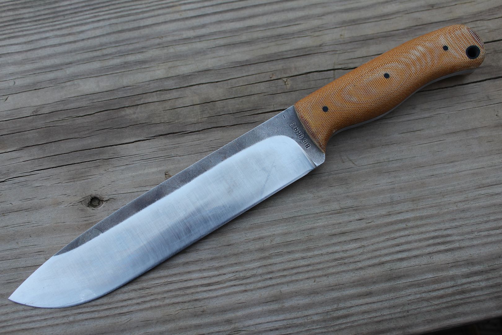

I have started watching Alone beginning with the first season.
It has really had me thinking about what I would want in a knife as my only cutting tool other than a axe.

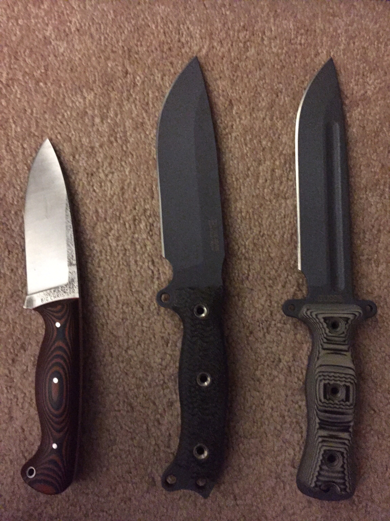

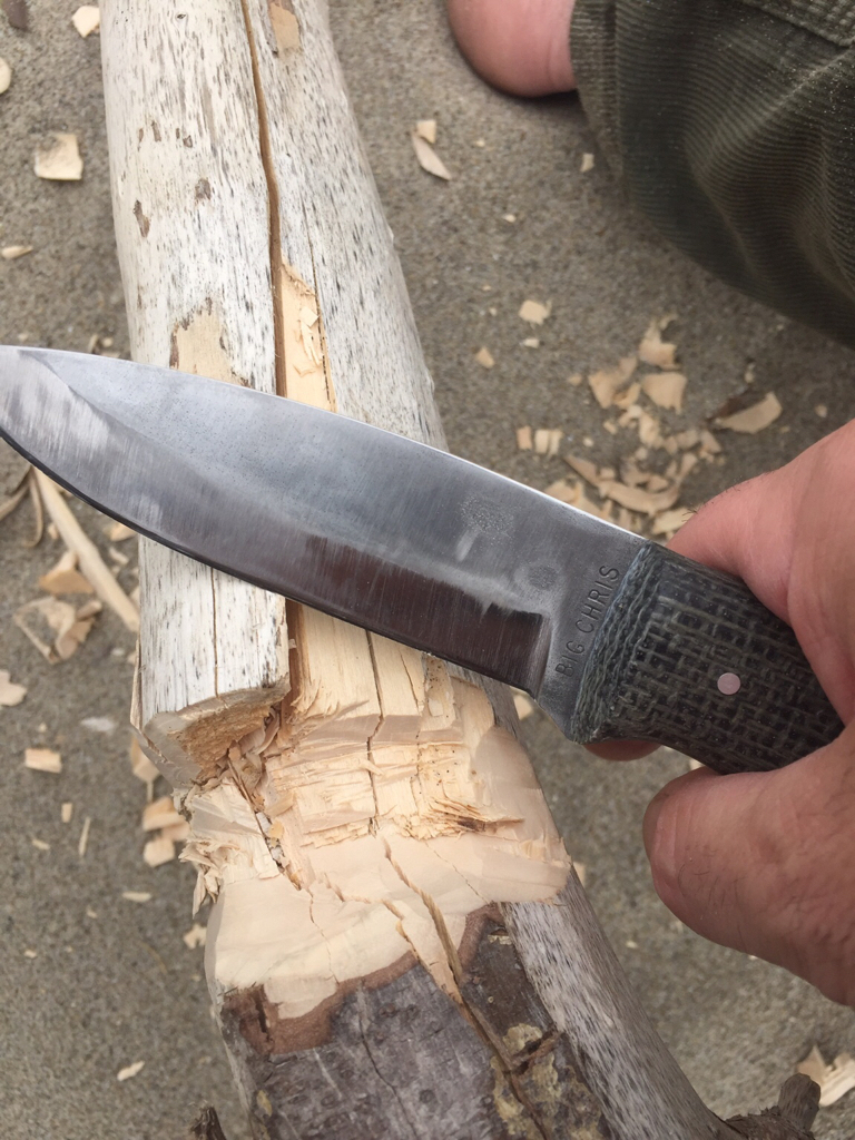

I have always said that I feel I could get by with just a Wolverine as my only knife.
While I do feel the knife is very versatile and would not be a hindrance, I think I may want something a bit different.
My thoughts now are that I would want a little more length as well as some more belly.

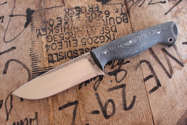

This next knife would also be very useful in a survival situation.
The drawback with this one is the handle shape.
I feel that it really limits the comfort in certain grips.
My ideas now would be for a knife with a 6" to 6.5" blade that is 1.5" to 1.7" wide.

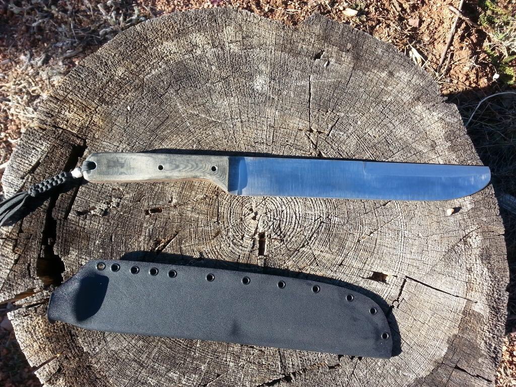

I have made several different versions of Camp Knives but I think I would want my Survival Knife to be a mixture of a couple.
I like the blade shape of this this pattern and it is also very handy for multiple uses.
This one just has a little too pointy tip which could break off right when you don't want it to.

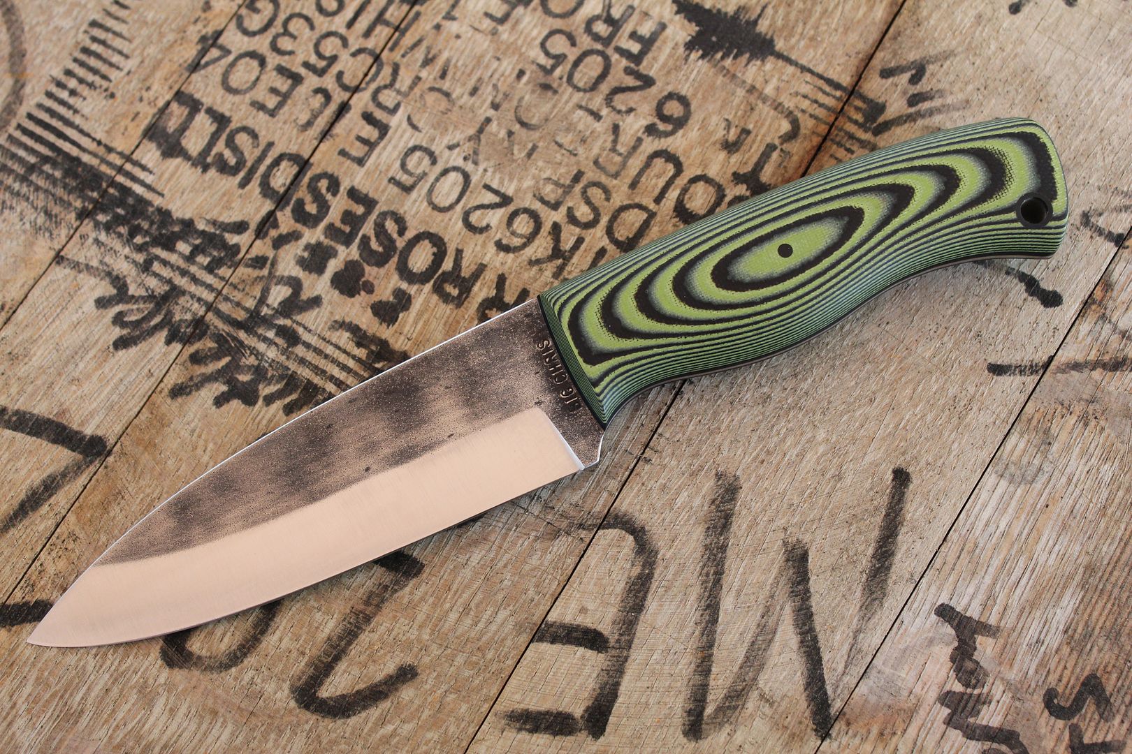

This one I feel is the most viable candidate for a starting point.
Shorten the blade, give the edge a little more curve, and give the handle a little more downward angle.
I think that would make a winning combination.

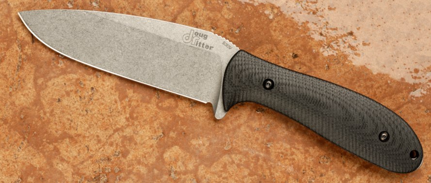

I am very happy with the handle on my Woodcraft, so a scaled up version of that knife with a slightly higher point would be great.
There are also a lot of classic good design qualities to work with in a somewhat refined version of a traditional butcher knife with a really comfortable handle.
The last knife (with the tan handle) seems to be going in that direction, although it has more of a drop point.

I feel there are two divergent paths regarding "survival knife" design, exemplified for me by the thoughts of two different designers, they being Ethan Becker and Doug Ritter.
On the Becker side, you have the bigger, overbuilt knives, and on the Ritter side are the smaller, easier to carry "always on you" style of knives.
Ethan's full size knives are beasts, and can definitely take a beating, but you certainly feel the weight of them when schlepping them around. Doug's Benchmade RSK Mk3 is designed more around his ethos of a smaller, lightweight, and easy to carry blade. After all, you never know when you will find yourself in a "survival" scenario, and your big knife does no good if you decided it was too much to carry on your belt that day.
Of course, I like knives that fall somewhere in the middle. I appreciate the lightweight/ease of carry argument, and I don't need my survival knife to necessarily be able to chop (although it could), but I still want something a little "more" than the 1/8" thick Ritter knife.
Chris, I think the Hiker of yours that I tested is a perfect example of how this can be done. Very lightweight, but comfortable, and 5 1/2" of 3/16" 3V steel is tough to beat.
I also think there are a couple "features" that every "survival" knife should have, mainly something of an index finger guard for protection and a lanyard hole for security. Should also be full tang and capable of withstanding the abuses or batoning through hardwood.
Lack of a finger guard on a survival knife is a deal breaker for me. If I am fighting frostbite in my fingers, the knife is going to be hard enough to manage already... the last thing you need are your digits sliding forward onto the edge because you are having trouble with fine motor control.
Protruding tang? I'd usually rather not. While they can certainly be useful for thumping on stuff, I prefer the comfort of a flush tang.
My blade shape preference for a survival knife would be a versatile drop point... enough belly to skin but still a fine enough point for more detail oriented bushcraft tasks, as well as potential "wildlife self defense"... a fine line to walk.
On steel selection, I like a good supersteel as much as the next but there is also an argument to be made for a steel that wont hold an edge as long, but will be easier to sharpen. Depends on whether you are planning for the benchmark time of 72 hours or for a longer term scenario. For longer term, I would definitely want the ease of sharpening. Short term, it would probably be moot.
So in summation, I definitely err on the "smaller" side of things when I think of a survival knife, but if I knew I was going into an "Alone" type of scenario, I could definitely see myself going slightly larger, so long as the knife is still manageable at the smaller stuff like making trap triggers and bush expedient wood tools.

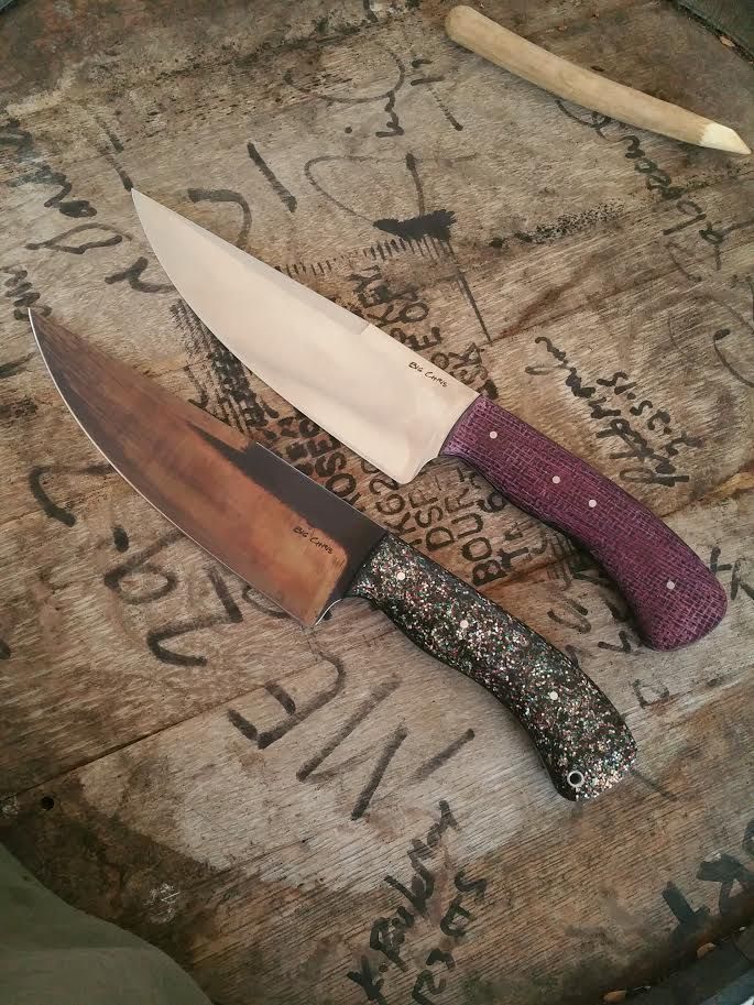

Fancier, a butcher styled knife was my first though as well.
Very versatile blade style, but am thinking about something with more curve to the edge.
I have not found straight lines and edges to be beneficial with outdoor work.
Personally, I get better curls and find that blade style does work more efficiently.
My thinking is also that 6" gives enough edge for cleaning fish and light chopping, but is not too long for working with smaller game as well.
It is also a good size for self defense if needed.
That is also part of my reasoning for a slightly pointier design.
A slender tip will pierce skin easier. This will make small game and fish work easier.

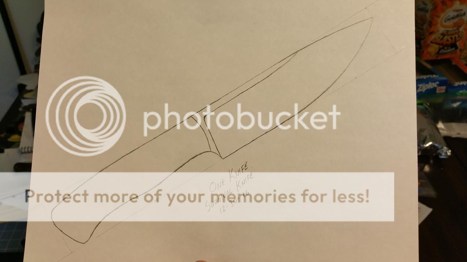

I sat down today and sketched out what I have had in my mind for this "One Knife".
Now remember that I plan to have an axe as my main heavy duty chopping tool.
This knife is 11" OAL with a 6" Blade.
I plan to start on a couple very soon.
They will be made from some 3/16" O1 that I have on hand.
