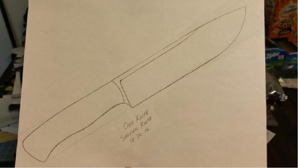

One Knife Survival Knife
Here is a picture pre heat treat
Weight is just over 9 ounces here.
Hopefully after tapering the tangs and gluing the scales on they will remain between 10 and 11 oz.
Very nice
Chris, I took your drawing and modified it to my take on the One Knife. I lengthened the blade from 6 to 7 inches, increased the straight portion of the edge and gave it a little more belly at the tip end. It leans a little more to the chopping and defense capabilities, without adding too much more weight.
OneKnifeRedux_zpslnmbhw0v.jpg~original
I thought earlier today that it would be nice options to offer a 6.5" and 7" version as well.
Really cool modified design, like it. Enterprise gets my vote, you can call it the Big E, like the carrier.
Alone Knife = AK - Big Chris Alone Knife = BCAK. If you want to get a bit Matrix'y you can go for the the Big Chris Neo Knife (for the One). Just spit-balling a bit.

David,
It's like you are reading my mind.
As I was sanding some handles today I was discussing that exact topic with myself.
I like a rounded spine because: 1-it gives the knife a finished look, and 2-a sharp spine will destroy the inside of a kydex sheath.
My idea was to use a 1" diameter small wheel to cut a small scallop in the spine to scrape with.
I could use a larger wheel if a larger area is needed.
I prefer a rounded spine, also. But 90% of my customers want a squared spine on the "survival knives," if that's helpful to you.
Sam

The photo pre-heat-treat looks like a super-versatile combination of blade profile and length, overall length and, from your spec at 3/16” with skeletonized tang, just the right construction to keep weight down while offering dependably high durability. I like a rounded spine, just me.

I will play with finishing the spines differently on these.
Rounded at the handle for thumb comfort, a couple inches left crisp, and finally a treatment at the tip be it rounding or a swedge.
I had already tossed the idea of a small swedge at the tip to aid penetration.
Not really enough to weaken the tip, just enough to make it slightly more acute.
