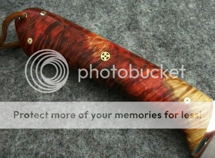

HERE IS A SPEAR POINT FOR A HOMETOWN FELLA AND B.F. MEMBER
"JUST1MOR" THAT WANTED ME TO MAKE HIM ONE,IM NOT BIG ON SPEARS BUT ITS WHAT HE ORDERED,ITS STOCK REMOVED FROM 1 1/2 / 5/32" 1095 FROM ALDO, MEASURES 9 3/4 OVERALL WITH 4 3/4 BLADE, WELL HERE WE GO
STOCK REMOVED
NORMALIZED 4 TIMES
ROUGH GROUND AT 50 GRIT TO REMOVE THE SCALE
INTO THE QUENCH AND OUT
INTO HEAT TREAT TO TEMPER FOR 2HRS,1 HR EACH TIME
OUT OF HEAT TREAT AND GROUND UP TO A 800 GRIT FINNISH
I FINNISHED THIS ONE UP,800 GRIT BELT FINNISH,THUMB NOTCHING,MOSAICS AND LANYARD,WITH TOOLED LEATHER SHEATH,THE SCALES ARE NATURAL FLAMING BOX ELDER BURL,WITH A HINT OF WHITE TIPS AND SOME SMALL BARK INCLUSIONS,BUT THATS WHAT MOTHER NATURE GAVE ME TO USE,TURNED OUT NICELY,ASWELL ITS RAZOR SHARP AS ALWAYS,ENJOY BILL
BESTS BILL
