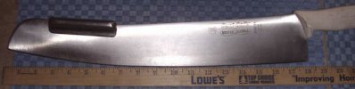

all you need to set up to use the wheels is a 1/2 hp motor that runs 1725 rpm, an arbor attachment and thats it. i practiced on an old hacksaw blade instead of a knife which worked well. when i could go from one side around the end to the other side and get it all shaving sharp i knew i had figured it out.
a few weeks ago i sharpened a couple of pizza knives (see picture) for a local pizza shop. both were 18" long and it took not quite 2 minutes to work up a burr on each one. both were extremely dull and chipped in a few places. i did use a belt sander set at slow speed to work up a burr and to help remove the chips. if there were no chips i would have used the abrasive wheel which would have taken the same ammount of time.
there are 2 wheels, 1 with abrasive grit glued to the outside and the other is smooth with slots every few inches apart to reduce heat and help break the burr. a white rouge is applied to help remove the burr and polish the edge.

Do you use wheels knife edge up or down? Does the blade ever get flung by the wheel? Thanks guys.
the only way for a knife to catch is if you go edge first into the wheel. i have been using the wheels for going on 17 years and havent had anything happen with the paper wheels. i sharpen with the edge facing me and the wheel rotating to me. i hold the blade at about the 1:00 position or lower depending on the blade and kind of cutting the knife will be doing. most of the time i just match the same edge unless specified otherwise. i here is a link to a vid showing me working up a burr on a knife before switching to the paper buffing wheel. it doesnt take me long to work up a burr or remove it. when doing a convex edge i switch to my belt sander then finish up with the paper buffing wheel. http://www.youtube.com/watch?v=plMbnQMQJMg here is a video of a knife i made slicing newspaper after being sharpened with the paper wheels. http://www.myculpeper.com/richardj/MLNA0018.AVI
