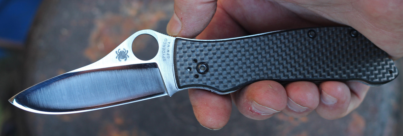

Here we have a mini barrage in silver shed CF with standoffs.
