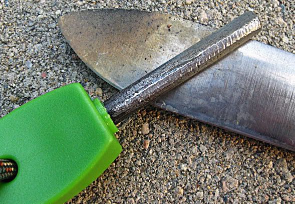

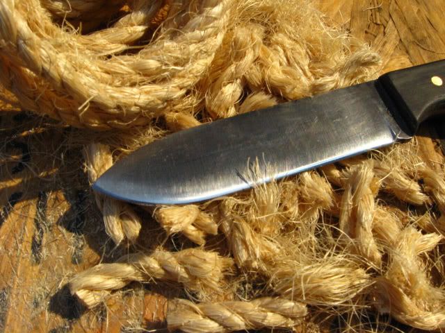

I had a fun time with the senior, lots to like about this knife. I really like the overall simplicity of the design. The micarta handle feels secure and looks to be a very long lasting durable material. The knife arrived working sharp, I used it as is. The spear point tip appears stout, so I ran some tip tests, stabbing the knife into a semi punky log I have by the wood pile. I stabbed and pried till I broke a sweat, no damage to the tip at all. Next up was a little baton work. I know this has been done to death, but that didn't stop me from splitting up some seasoning oak. The PSK goes through like no tomorrow. I also wanted to see how well this knife mates with a quality fire steel, no surprise here, tons of sparks with the Light My Fire Scout, no damage to spine that could not be wiped away. Moving on to some rope cutting tests, I sliced up some sisal that is notoriously tough on edges. I made about 30 cuts, also taking note that I was not getting any hot spots with this handle. I then handed the knife to my wife, busy in the kitchen preparing dinner. I gave here instructions to cut up the salad veggies and give me some feedback. I am happy to say that she enjoyed using the PSK, thought it was sharper than anything in the drawer, and hinted about getting one for the kitchen. Pick a number love, was my reply, I'm first. I found the kydex sheath to be well built and it firmly locked the knife in place, you could use it as is for neck carry, although my personal preference for a knife this size would be belt carry. I would like to see this knife with hollow pins to fasten the micarta, I think they have the edge in strength and more appealing to MY eyes, not that there's anything wrong with solid pins. I found the overall length, blade/handle ratio to be just right for a bushy craft type of tool. The weight at just under 5 oz. is perfect in my book. I could use it all day and never feel fatigued like I do with thicker knives. This is a keeper and I have convinced myself that I need one. I want to thank all those responsible for making this passaround possible, it sure was a lot of fun.
