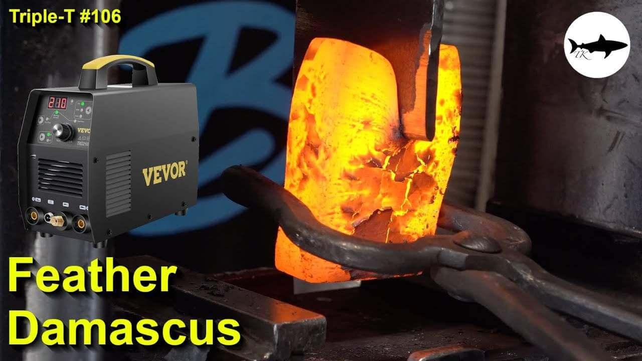

I've only ever seen this as the "river of fire" pattern where you do it on a piece of feather Damascus, but it seems fun for a lot of things. My main questions are:

So I saw this, and I gotta say I find their explanation very confusing bordering on useless. But it looks like from watching the video that he's using a 1" thick billet at the end and grinding the wedges down till there's about 1/4" left of the edge bars at the bottom of the notches and using a 2" wheel. He doesn't give specific details about the dimensions though.
