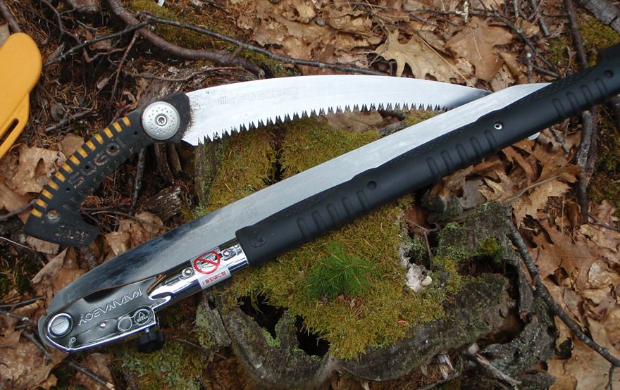

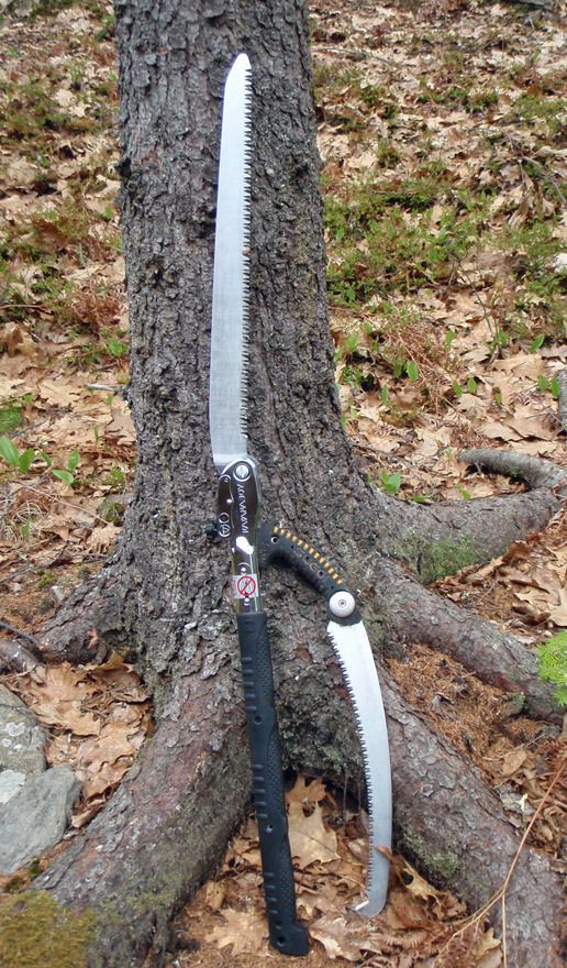

Here are my 2 favorites -
As you can see they are not back pack saws, not even camp saws, unless you are driving in to your camp.
The one in the orange sheath is a Sugoi 360 with the curved blade and aggressive sharp teeth that will saw through up to 5" soft wood so easily and 3" or 4" hardwoods with a little bit more effort - all one handed.

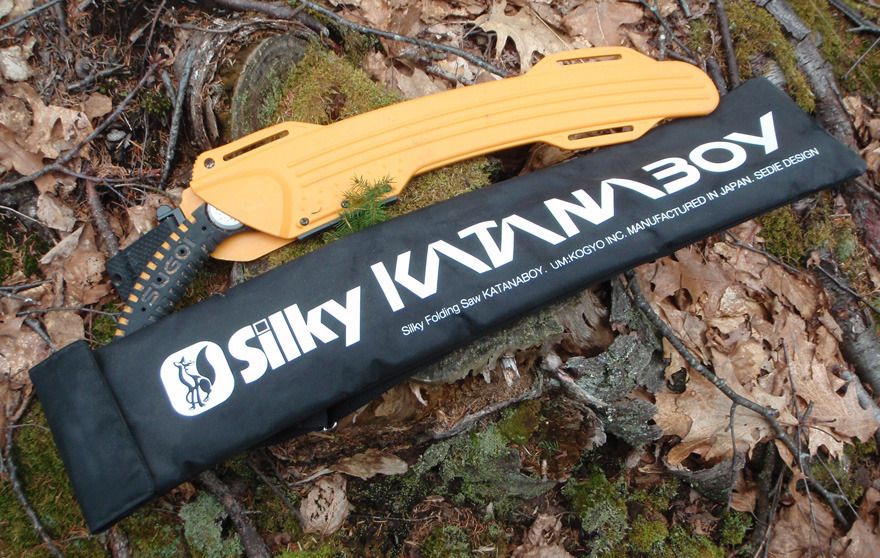

The folder is a Katanaboy - a 46" overall long tool with a 21" blade that makes me laugh every time I use it. OMG can this saw cut through a log. If you don't have a sharp chain saw this is a good substitute. More sweat involved (a two hander) and a bit more time than sawing with the chain saw, of course, but it is quiet and cuts with a great satisfaction.
I do not hesitate to recommend Silky saws in any length or toothiness. I've had other brands, including 4 or 5 Sandvik and Fiskars of all different sizes - no looking back once I tried the Silkies.
