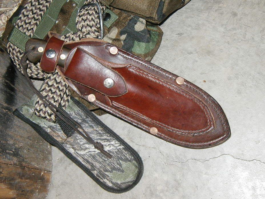

I carry a two knife set (pic links below). They are both in the same sheath and always with me. Whatever the circumstance, I have a head start in putting the odds in my favor. ;) :D
http://i40.photobucket.com/albums/e219/spiritbow/Knives/Pathfinderset.jpg
http://i40.photobucket.com/albums/e219/spiritbow/Knives/Pathfindersheathedfront.jpg
My decision is based personal survival experience. Simulate a true survival circumstance, as best you can, and what you need may over-shadow what you want. Some people do not function well having gone without food (some sugar thing, I think). While others, are hardly aware of the inconvenience. Under a controlled environment simulate no food, possiblity of injury, frustration, anger,etc. Then practice what you must do to deal with it. My big knife - wouldn't leave home without it. :D
