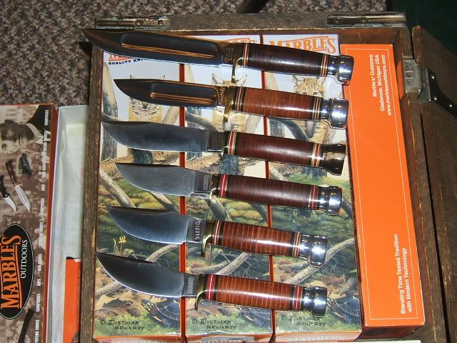

Did someone say stacked leather? :D Did I say I like Marble's knives? Well I do!
i like those stacked leather ones as well.
nothing wrong with leather, i know case makes some really nice ones.
