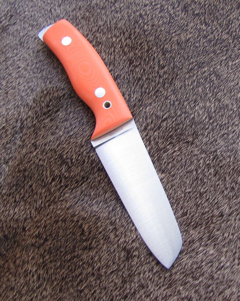

Here it is.

Really good design. That should've smacked us in the head. Stanley came up with a real winner. Scott, keep that template, I have a feeling this design will be in demand. UNK combined with a Deer Creek is a great idea!
Looks great Scott!
For future interest in this knife here is a cut and paste of my original idea.
I call it the CFK or Compromise Field Knife.
It has the UNK-style blade to excel at gutting, skinning, and butchering.
The blade is tall, thick, and long enough to excel at bushcraft tasks.
4.25" Blade with a 4" cutting edge.
4.5" handle with an additional 3/8" exposed tang.
3/16" thick and 1.5" tall.
This one is S-7 steel.
-Stan
I really like this design. Dual purpose as stan intended. Great for hunting and general woods use. Alittle large to EDC but I can't think of anything it wouldn't be good for.
