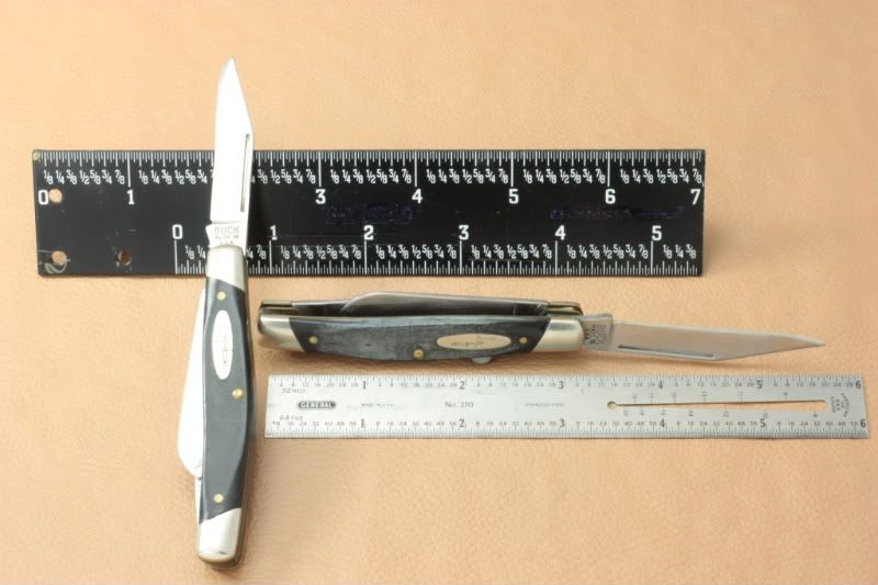

I have always like the design relationship of the scale rivets, blade grinds and knife bodies shape in the Schrade made Bucks. These 301s are the Swinden versions. I will state that of these type I have carried none has been abused by me and they continue to perform with excellence. The first model has the grooved bolster, then one without and finally the version with Buck on reverse of each secondary blade. These are 1966 thru 1972, made in what was to become both the Buck 301 and 303 models. The contract was changed in the early 1970 to a company with thru pin bolsters so blade work on repairs could be accomplished faster. 300Bucks

One of my favorite knives is the 303 sized Schrade Buck. It just is. You know what I mean. There is stuff that just is, and this is one of the knives for me that "just is". I will be honest and admit to grinding on the toe of the sheepsfoot tang to get it down a hair but that's OK with me.

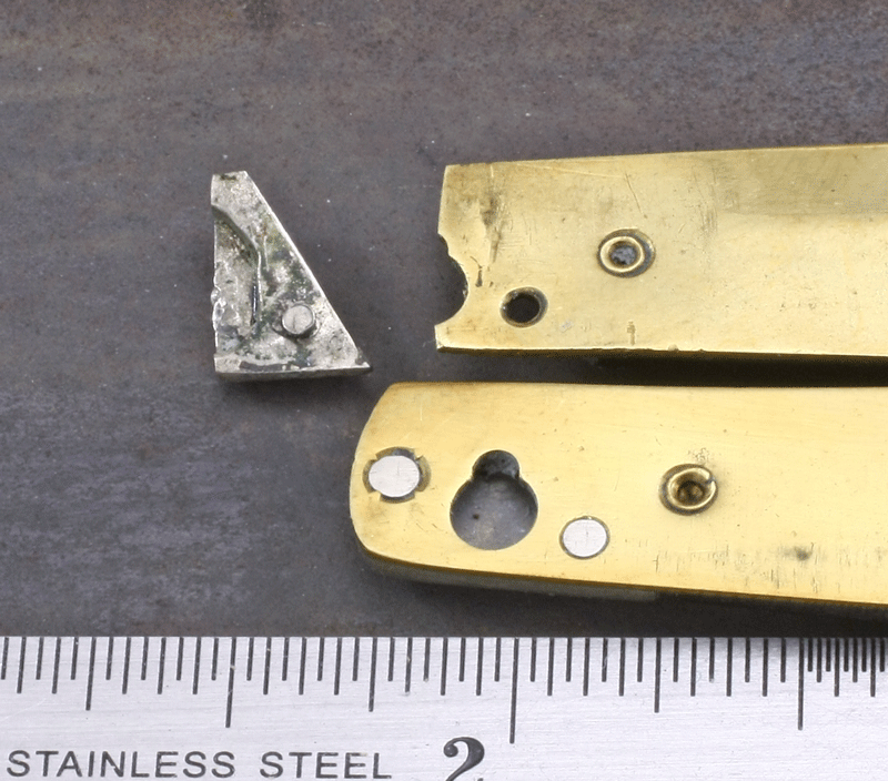

Found the parts and will take some good close-up photos for the record and include in thread. The 303 size knife that I ground down to mid-pin, I went ahead an pryed off the bolster and it required some force but the pin you are calling the anti-rotation pin popped lose. Under magnification it appears to have a lip in the liner around that hole. Will take photo of that, but the tommy pin was ground off. I have a second liner with both whole bolsters and the front pin looks peened and ground flat for certain. Will take photos for the records. I think the anti-rotation pin is tight but the front pin is the main pin. To be clear to others we are talking about the pins that hold the bolster to the liner, NOT about the blade pins. 300
Well, Here goes some more photos. I have just about beat this horse to death, but just a little more to honor the brave knives that gave their lives to our better understanding.
Here is a 303 size Schrade contract Buck, hereafter called a 303, showing the forward tommy pin with peened and ground flat head on bottom liner, the Swinden key hole for the blade pin, the empty anti-rotation pin hole and the piece of remaining bolster (on the top liner) from my photo of the slice down the middle. The piece of bolster had to be removed with some force, but see the pin formed with the bolster and notice a very slight ring in the empty hole it grabbed on to. Also notice the hollow scale rivets with rolled over edges.

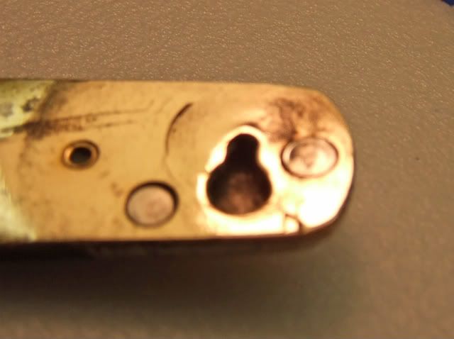

Here is close-up of tommy pin hole.
Here is the Swinden hole and bolster pins showing. You can tell the tommy pin is peened and ground flat.

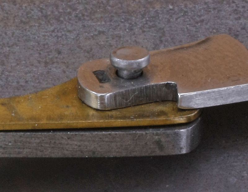

Here is photo of the Swinden pin on the pin blade end of a 303, it gives you more visual of how things work. Middle brass liner and spring.
That's how it was in the Buck contract knives and likely close to the Schrade models also. Probably more than you wanted to know.
