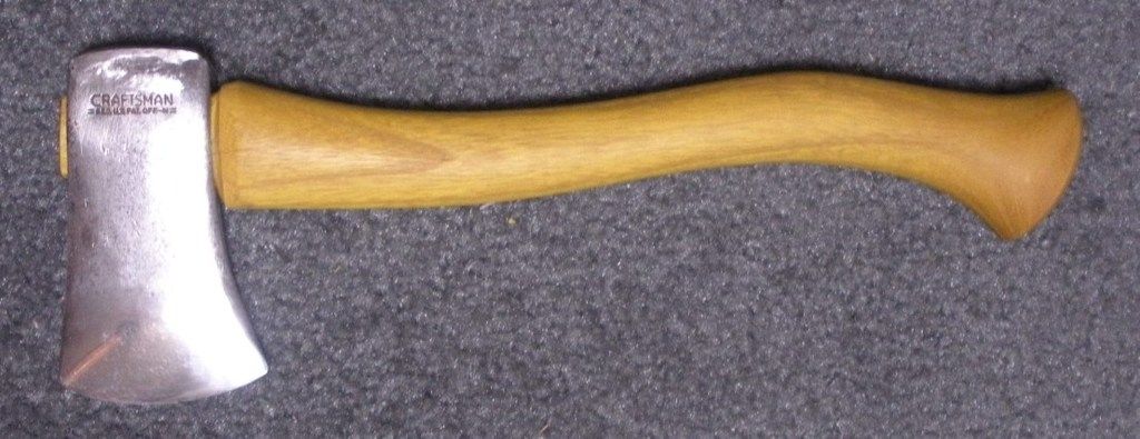

Here is another small hatchet that was kindly gifted to me. The head on this one comes in at 14 oz. I actually took the time to document the hafting process on this one. First up was some clean up and re-profiling work on the head.
Then it was time for the haft, an 18" hatchet handle from house handle that I never liked on the head it was originally fit to.
I thinned out the handle significantly and began to fit it to the eye.
Like many I test fit multiple times getting the handle into the eye a little further each time. In this case I was lucky to have part of the old haft to use as a drift.
Almost seated
Last fit before the finishing work begins.
Sanded and a little BLO applied.
Finished, I still need to get some in use pictures.
