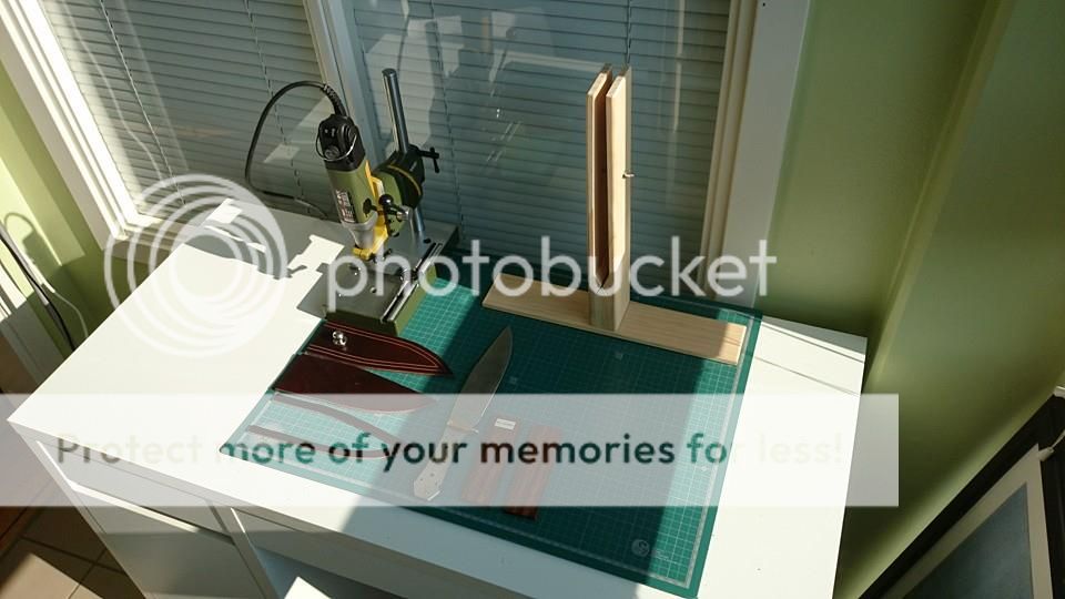

I'm going pretty slowly, but I want to make sure I get everything done right. Will post more pictures later:
Looking forward to more photos!
Could you also describe your drill/dremel set up in detail?
Thanks!

I, too, am curios about the dremel/rotary tool set-up. Also, where did you source the stud? That's a bit larger than I'm used to seeing, but then I've seen them made by the knifemaker, as well as folks using miniature (doll house or the like) drawer knobs.
Very clean so far. Looking forward to more pics. :)
