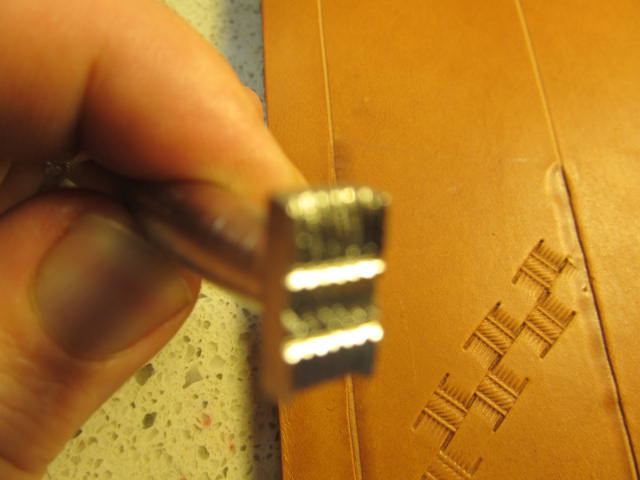

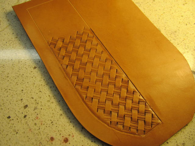

That's a nice clean looking sheath! I think that with basket weaving you typically offset your stamping to give the 'weave-y' look to it. Something like this-
That being said, it still looks good as it is! I watched Chuck Burrows' sheath making DVD again over the weekend and he said something to the effect of "There are wrong ways to do things, but there can be plenty of different right ways to do them too."
Found a pic of the above one when I started it, if it helps make more sense. It helps if your first line of stamps isn't as crooked as this one started out.:D
Thanks! I actually was trying for the more 'weave-y' look, but will admit to continually getting confused on tool placement (even after watching some videos and practicing before starting the project)---what you see is the only way I could wrap my mind around it enough to get it done. (My first attempt was a complete disaster) I'll probably give it another whirl this coming weekend and we'll see how it goes (practice, practice, practice!). I appreciate the input and the tool placement example above--very helpful.
