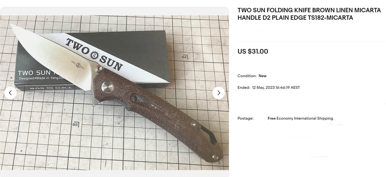

One auction buy : TwoSun TS-182 D2 knife ..
Blade steel D2 - It's hard , really hard . My 65HRC file skates over the blade like roller skates over a hard floor . ( Can I say that ? )
Factory edge was so bad - the knife would not slice paper .. So I had to do a 80 grit re grind at factory bevel angle .

Ok ................. Update !
Liner locking issue fixed ...
I bent or put a bow in the liner lock so as to dimensionally shorten it ..
This allows for more blade engagement or fixes the issue !
I put the knife to the guided knife sharpener at the same edge angle ..
The blade may have been a bit hard for the 80 grit wheel ( wet stone grinder - knife sharpener ) .
But it did clean up the edge ..
So hopefully the guided edge will be FUBAR-Less ..
I went to 320 Grit Diamond .. ANd it slices paper very smoothly and takes hair off my arm with ease .
Was going to go 600 Grit Diamond , but the 320 sliced paper so smoothly - I just had to wonder if there was any point ?
