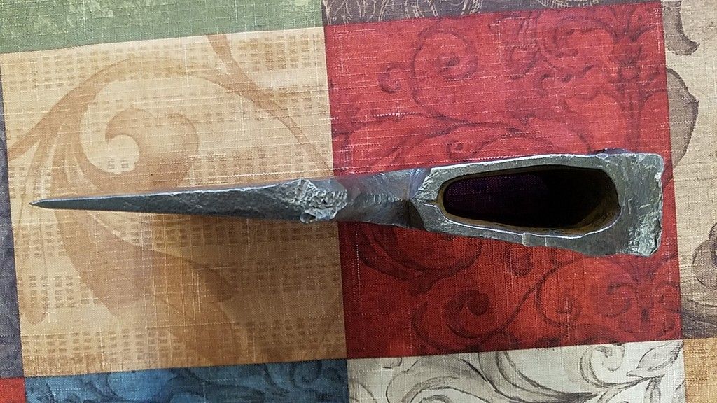

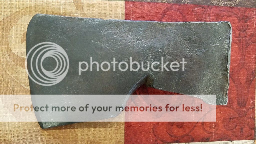

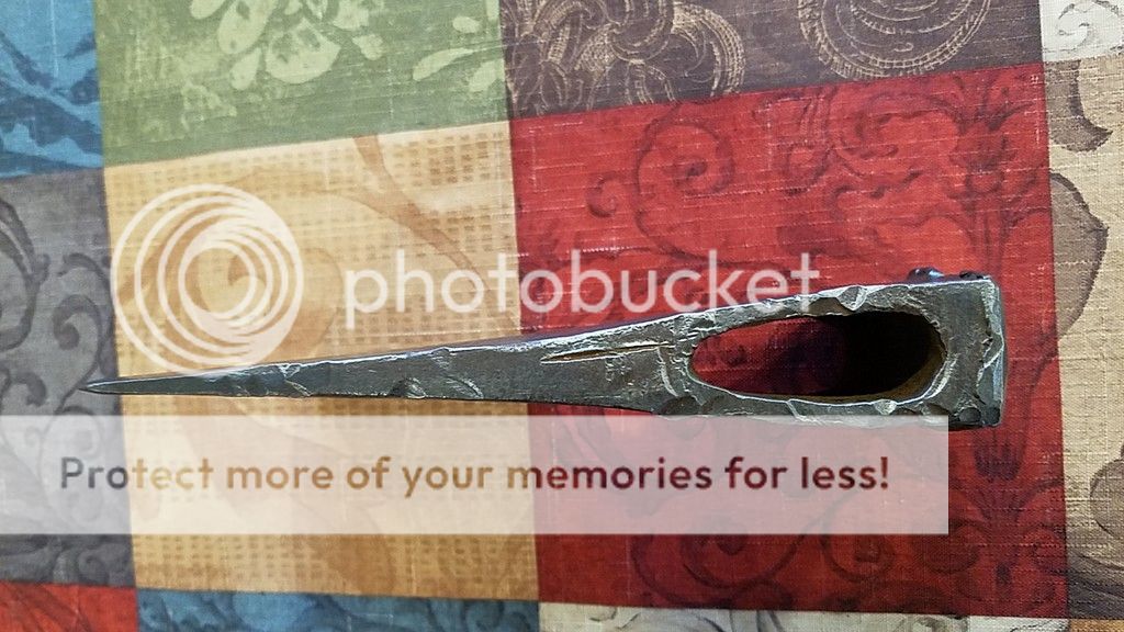

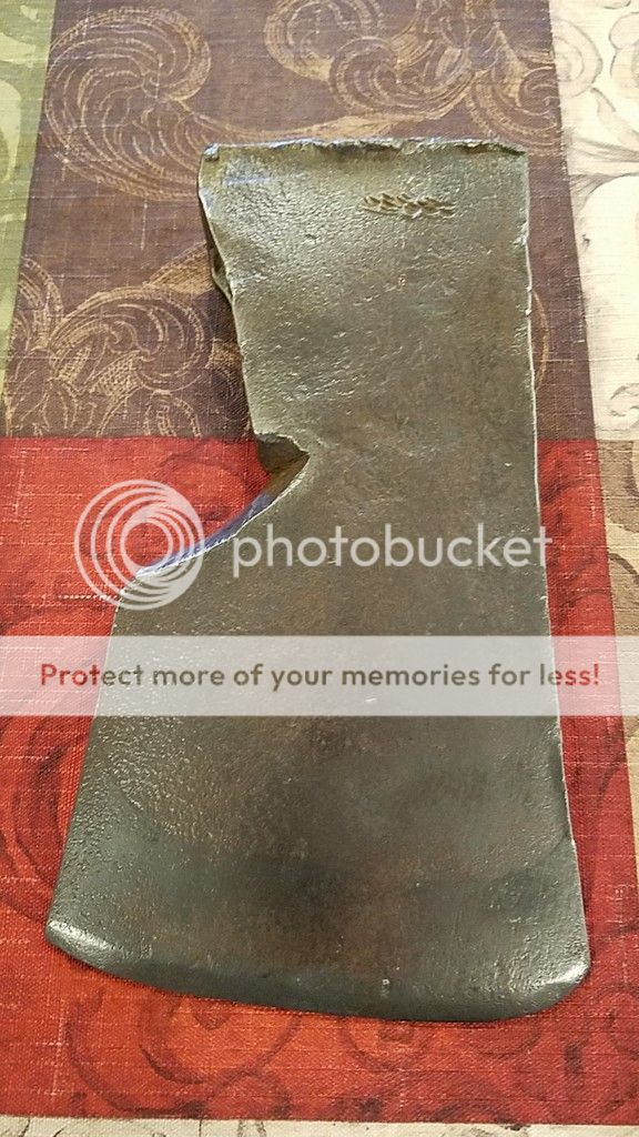

Here is one that I just picked up and cleaned, but it is a new style to me. The eye is smaller on top, so maybe the notch side is the top? A strange animal either way. It weighs between 3.75-4 pounds, and is 8" long with a 4.75 edge. It has a deeply inserted bit.
Something about the eye-poll transition makes me think it's Slavic in origin.
It's European, that transition is pretty common throughout Europe. Now, the vertically tapered eye (longer "face" of the poll than at the side towards the bit) is less common, this is where I think Agent_H nailed it.
Hjärtum yxa?
Here is a thread on one that looks pretty similar.

Neat type of pattern to happen upon!
A looker for sure! (And we have a new Sherlock Holmes in the house it seems! :) )
Easy to see the transition in the two steels used in that axe. Another nice find.
I'm not picking up the transition between steels on the top and bottom of the axe. Can you take another photo?
I see northern European in that axe but I also see some American influence in the poll. I would guess it was forged in N. America by a smith of northern European ancestry. Maybe a one-off piece. If it's actually an inserted bit not an overlay then it's likely quite old - maybe late 1800's.
Surely a super cool axe!! Thanks for the pics!

Very much doubt any New World influence in this,a very common Norwegian carpenter's/shipbuilder's axe(this design pre-dates Europeans on this continent).
It appears to be forged under a (fairly massive) power-hammer,so would very like date to late 19th-early 20th c.c.,Norway....
Upon becoming Americans,Europeans seemed to've liked shedding their habitual tooling,and the times were changing as well...Building was less and less done using an axe...
Some tools are known to've been brought to the New World,but quickly discarded here,for whatever reason....(a good example of this would be the "goose-wing",a Germanic-style broad-axe....).
So fairly unlikely to have been forged here,in the USA,the wooden-construction tooling had undergone too many changes...
That looks like a winner! Where the bit meets up with the collar looks more like what you found than the other ones posted.

Right, and that second link describes a backwards eye just like this one. I honestly don't feel like dealing with the challenge, I will likely sell this one off.
Pa. makers like Stoudt, Strauss, Stricker and Stohler had axe eyes that were narrower at the top than bottom. Just hang them proud and wedge fat. I understand Mustad axes are very good quality but have never owned one.
