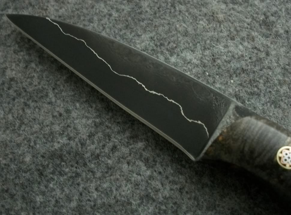

NOW I GIVE THE BLADE A GOOD HARD BUFF AND CLEAN IT UP WITH GLASS CLEANER AND HEAD FOR AN ACID BATH FOR A CPL MINS
NOW I HAND RUB THE BLADE UNDER WATER TO REMOVE THE EXCESS ACID THE GIVE IT A SOFT BUFF WITH WAX TO SHOW ITS PATTERN

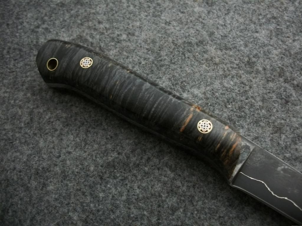

NOW WERE READY FOR SCALES WILSON WANTED SOME DYED MAPLE BURL SO THATS WHAT HE GOT IM GLUED UP ON ONE SIDE AND READY TO DRILL HOLES AND APPLY THE OTHER SIDE
NOW I START PROFILING THE SCALES WITH A 60 GRIT BELT,THEN I START HAND SANDING FROM 120 TO 1500 GRIT THEN PUT THE SPIT SHINE ON!!
2 DIFFRENT BUFFS THEN A WAX COAT,PICS DO IT KNOW JUSTICE GUYS

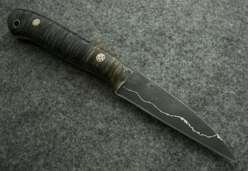

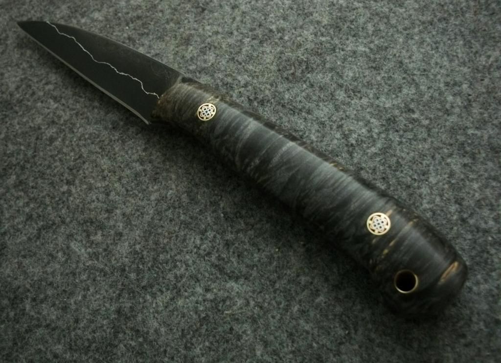

WELL AFTER ALL THAT HERES THE FINNISHED PRODUCT PICS DO IT NO JUSTICE ILL TRY GET SOME OUTDOOR PICS TOMMOROW
LANYARD AND BEAD WILL BE ADDED, 8 3/8 OAL WITH A 3 3/4" BLADE
FINNISHED:thumbup::D
