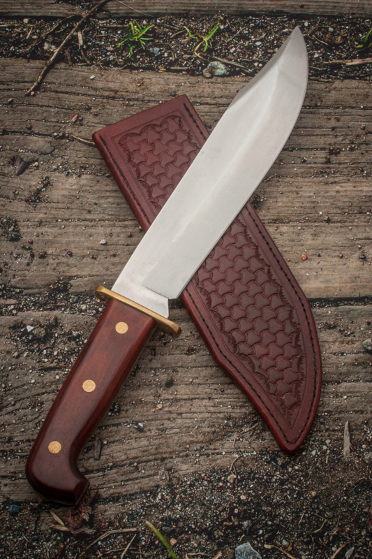

The knife as it looks at the moment.
Reground the already convex blade but now to a zero edge of about 30 degrees inclusive & contoured the handle.
Still have to work on the swedge & guard and restitch the sheath.
I'm currently experimenting a bit to find out if shimming the guard with a few small pieces of brass sheet is a viable option.
While it works very well to immobilize the guard 100 % even during maximum force chopping (just tested the knife again in the woods an hour ago), the shims need to be smaller to be totally invisible.
The 1095 Cro-Van blade steel also holds up well; after taking down several thin trees / thick saplings (think upper arm size) the edge can still shave the hair from my leg.
And this is with a 400 grit wet & dry SiC finish deburred with 1.0 micron diamond compound on MDF.
Thanks. I couldn't afford the real thing so I bought 2 replicas made by bear&son, both guards were loose. I read 2 or 42 knifemakers dicussing soldering, epoxy, etc to get that guard to stay in place, heard 2 or 10 opinions; since the knife is a work of art "whatever works" will be a unique solution.
Immobilized the guard with two narrow shards of brass sheet (one on each side), which were lightly tapped all the way to the tang using a small hammer & small section of a snap-off blade which i ground blunt & square.
The larger piece of brass sheet in the pictures is what was left after i used a pair of scissors to cut the two shards from, each one about a millimeter wide.
Also rounded the edges on the brass guard and polished it a bit.
