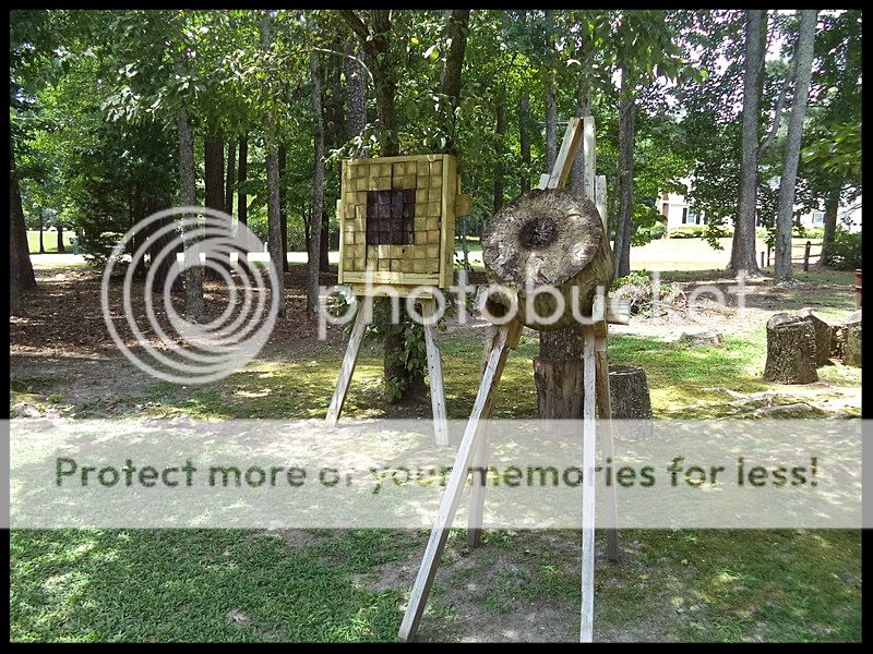

I can get my hands on rounds. What should I use as a stand? I was thinking of an easel type thing...
My knives should be here in a couple days. ...And so it begins.

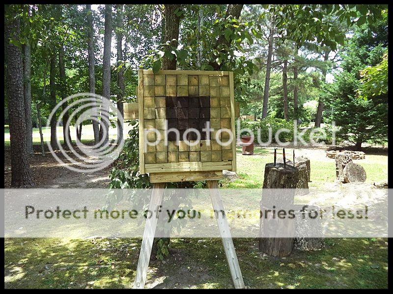

try this one:
built by Yuri Ershov (Fedin Knife Throwing), made of wooden cubical chuncks nailed into one.
I just bought a bunch of firewood rounds, four inches thick and about 2.5 feet in diameter. Got I think six for $20, set em up in the back yard against a berm, and got medieval on 'em.
I wound up leaning them against the berm and backed it up with a small firewood round... it's holding well.
