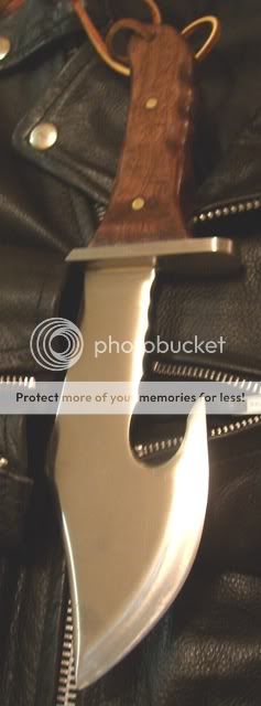

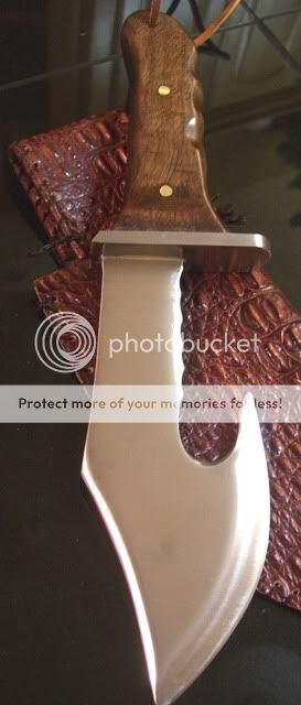

Steel is from ½ ton Spring. Heated in a forge to approximately 1700 degrees Fahrenheit, until blade became nonmagnetic, then dipped in a vat of oil. Fine satin finished. Tempered at 400 degrees for 1 hour, letting it air cool, then putting it in 1 more hour at 400. Blade was file tested for hardness. Very hard.

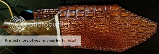

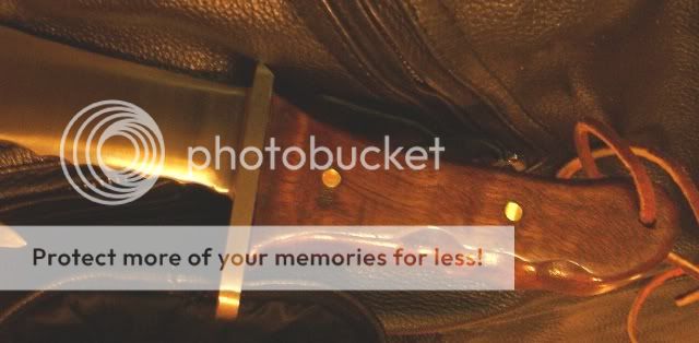

Handle is made of distressed Walnut and pinned with brass & epoxy. Sheath is hand stitched out of dark red gator hide.
Measurements:
Total Length: 11 ½ ", Blade Length=6 ½ ", Blade Width=2 ¾ ", Blade Thickness= 3/16"
Handle: Walnut, Handle Length: 5", Handle Width: 1 1/4" Guard: 2 7/8 long by 1/4"
Below are pictures of the finished knife.

Interesting knife. I am not normally a fan of such blades (there may be some physical problems in heavy use), but yours look nice. I would recommend a full tang on any future models.

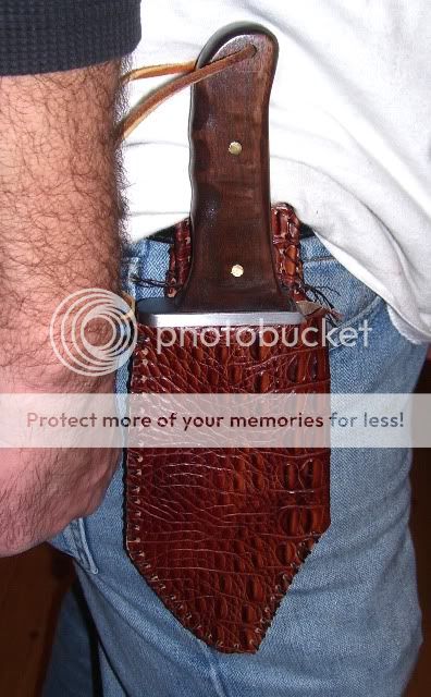

I am not sure I understand the reversed handle? Why is the butt curving against the hand? It seems it would be quite hot in the hand in use.

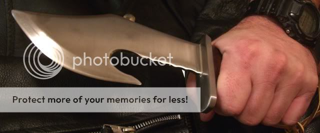

Hey, Thanks for the feedback. That’s kind of my thing. I like to do things a little out of the ordinary …. something unique. My idea was to give it a combination hatchet/knife look. I chose to have the butt go up instead of down because I thought it would help when it pivots when you’re swinging the blade up and then on the down stroke.
Sure you could kill a cobra with it, if you’re brave enough to get that close :) but you could also use it for hacking. I thought the blade had a look of the cobra head.
Chris, as a rule, you want a hande to have a downward curve when you're building a chopping style of knife. Look at khurki, machetes and competition cutting knives. When you swing hard a downward turned handle will "hold" onto your pinky and end of your hand, when it strikes, your follow through will lever your hand down onto the handle, if it's turned up it'll tend to lever out of your hand or apply a lot of pressure to the end of your hand. Think of the handle as a hook, at least that's how I look at them.

I like the exagerated WSK look! I even like the handle, but it probablky would be hot in the hand. My concern is the 1700ºF temp! Are you guessing at the temp? This temp would probably cuase a HUGE amount of grain growth even in 5160. 1525-1550ºf is all it needs to get hard and keep grain growth to a minimum. get ya some tempilsticks they'll help get ya into the right temperature ballpark. Great Craftmanship!

Archer, I'm enjoying the look of this one! Although the reversed arching handle would likely help the blade movement on the up swing, the down swing is where all the power in a chop comes in, and a normally shaped handle is more conducive to assisting in the downstroke. I'd also suggest some temp-sticks to get you in the ball bark of temperature for the heat treatment. 1700 would cause the grain of the steel to grow quite rapidly if it was held at that temperature for any time. This will cause the blade to become more brittle. This is a really weird analogy, but it's kinda like some really fat 800 pound people hugging each other vs. skinny people hugging each other. The fat people just can't get their arms around each other to hold on. I know, really weird analogy.
