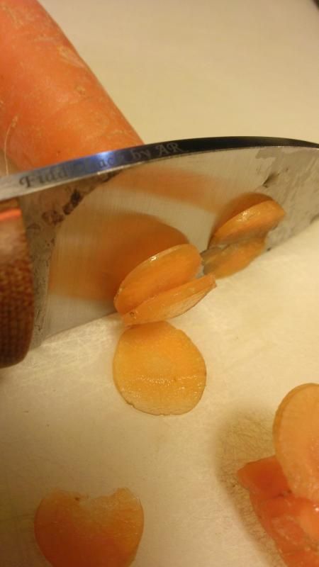

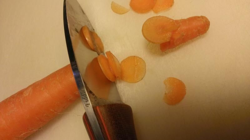

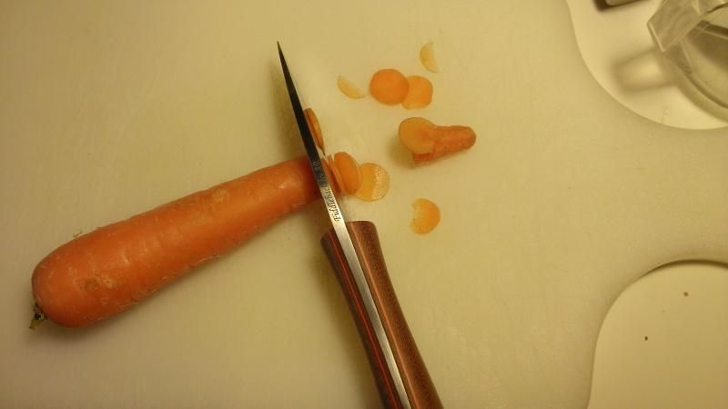

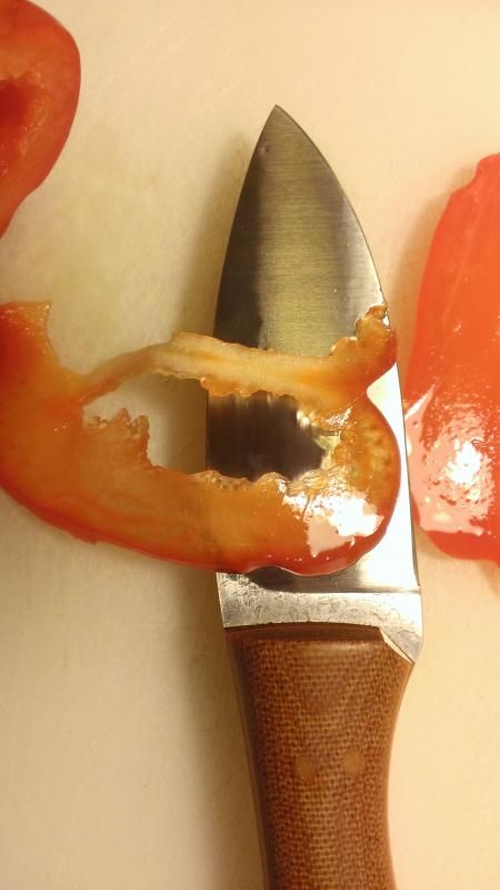

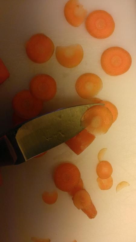

Hey Evany - I started this quest a while back to try and determine the difference, pros/cons of the various knives thickness. The best advice I can give you is to try it for yourself and go with what feels more natural for the task. What I decided to do was to take all my knives and put them all to the same test: splitting wood, making fuzz sticks, making various wood notches and doing this with both green and dry wood.
I tried my Mora at 3/32", my ESSE3 at 1/8", ESSE4 at 3/16", FB Bushfinger at 1/8", BK2 at 1/4", ESSE 5 at 1/4" and my Wetterlings Axe. Yes you can do everything with all of them but some knives do some things better. The Mora excelled at fuzz sticks and more precision work, you can still split wood but only very thin branches and even then it's not recommended since it's not full tang. The 1/8" knives were just as good at the intricate work and could split wood easier but the Mora felt more natural when making fuzz sticks. The 3/16" felt better at splitting wood and light chopping, it can still make fuzz sticks but I felt the 1/8" and below were better suited for that task. The 1/4" knives were tough as nails; I beat the heck of them: splitting knotted oak, chopping, etc. Excellent for those tasks but not so much at fuzz sticks, notches, etc. I love my Wetterlings Axe and I always carry it with for splitting, chopping and the heavy duty tasks.
Now that I've had the chance to test everything a few times my current setup is my 1/8" Bushfinger, a Mora (as backup, usually in my backpack) and my Wetterlings Hunters Axe. This is what I feel most comfortable with for now but it may change down the road since I'm constantly exploring other options. This week I secured a 5/32" FBF Hunter and a 3/16" FBF Nessmuk and I plan to put them through the same abuse. I don't care for my 1/4" knives as much as I used to but I keep them in case my preference changes. I'm sure others will agree/disagree with my choices but all I'm saying is that this is what works best for me and feels most natural (today). I'm not saying this is the best setup or preaching for one knife vs another or one thickness vs another. Try them all and see for yourself, I hope this was helpful. :)

Nice photo's Rob! If I could figure out how to post large photos I'd put some up myself, but I can seem to get that function to work.
The Bushfinger is an excellent chice, you'll love it! Regarding posting pictures, I had the same problem and here's what I did. I noticed that other members that post pics do it from external sites. If you right-click the image and copy the URL you will see that a lot use photobucket.com. Just create an account with photobucket (it's free) post your pic there and then use the forum link that photobucket provides and simply paste it here.
