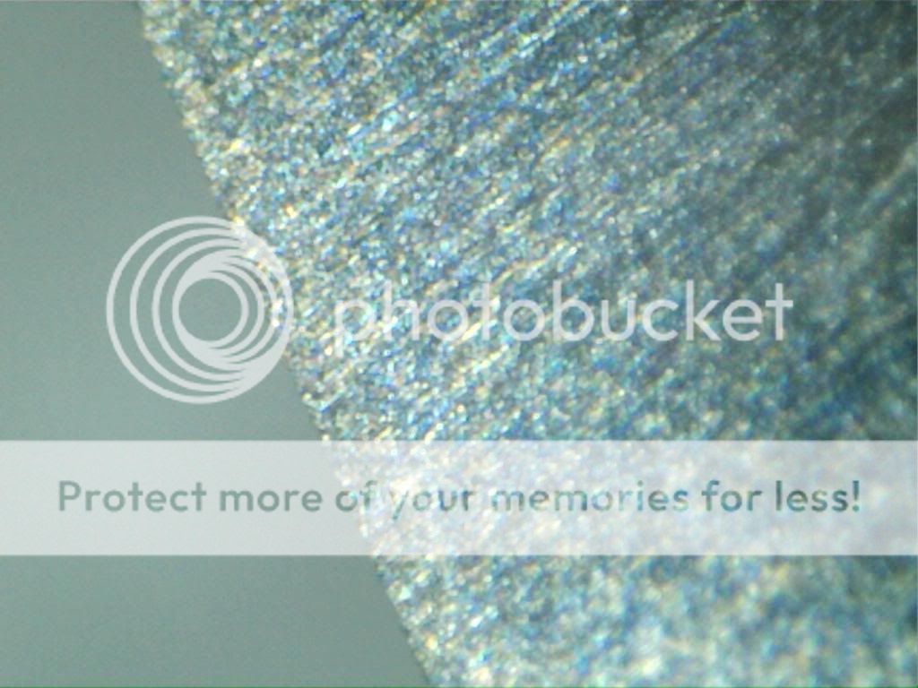

Heres a Jnat Edge on a Carbon Steel Maestro Wu Pocket knife. This particular edge well exceeds 30k.

For a pocket knife there is no need to go much past 3k-4k, there are not many pocket knives hard enough to support such a fine edge and the cutting ability is greatly reduced.
