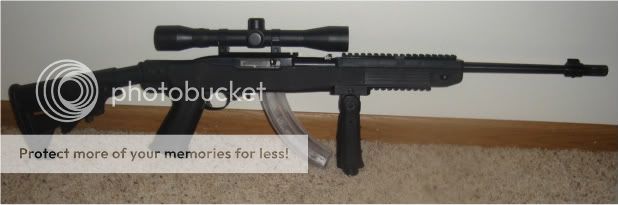

This is my son's 10/22! He's 10y.o. so the adjustable Tapco Fusion T-6 stock is KING right now! It has a Bushnell 4x scope, extended mag. release, flash hider, ATG vertical foregrip (this is handy!!) And the extended mag is a Butler Creek Steel Lips 25rder.
