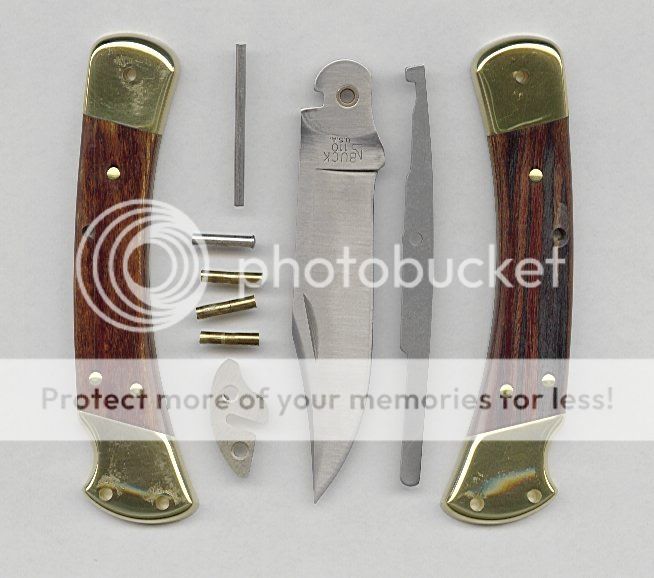

Howdy folks, been searching for an answer on the net but nothing so far. Are the bolsters, especially the rear, soldered on as well as pinned?
Thanks, Pete
The bolsters are part of the frame half. The front (1) and rear (2) pins hold the halves together. The bolsters aren't removable. If you see examples without a rear bolster, it was milled/ground off.
Agreed^. Each side is made with bolsters, front and rear. Then with the blade in the middle they are pinned together. If you see one
without a rear bolster, it has been sanded down/ off. DM
I would not have thought that. Makes what i'm about to do a little more difficult. thanks for the info. I recon I should find a cheaper knife to start on. :)
