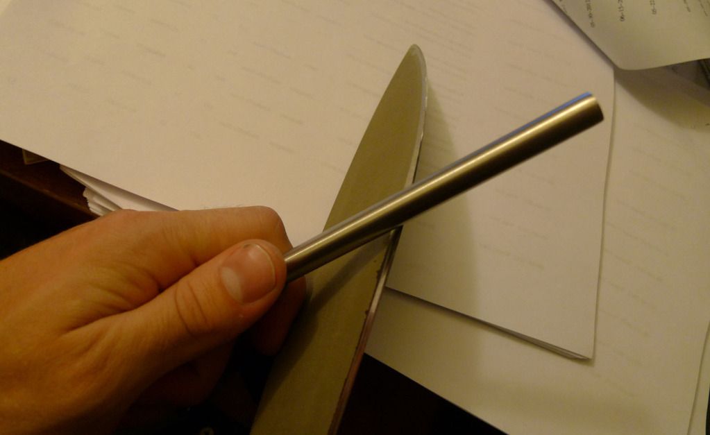

did you do any burnishing/steeling between deers?
Every time the edge dents, mashes, roles or ripples it no longer has the ability to sheer the material with the same resistance as the rest of the edge. when the edge is pristene and straight you lengthen the time of the impulse, which reduces the shock forces that effect the edge. When you have a roll the force hits the edge quickly, producing a fast impulse that applies a lot of shock force to a very small area of very thin metal. Each time it deforms further that shock force just keeps concentrating on it, deforming it more and more while the rest of the edge does fine (as long as it's still straight).
Impulse is defined as :
5. physics
a. the product of the average magnitude of a force acting on a body and the time for which it acts
b. the change in the momentum of a body as a result of a force acting upon it for a short period of time
If your willing to hit it with a burnishing rod (it's only a few ounces, and can bring an edge back without having to sharpen it especially with malleable steels like s7 and INFI) between deers or every time you see a bit of damage you might be able to avoid the kind of tears you saw after 5 deers.
Burnishing is a little different from steeling in that steeling is done with light pressure and is meant to bring the very final finished edge into alighnment and smoothen it out a bit (like polishing). Burnishing is done with more pressure, allowing you to knock dents back into alignment and move heavy burrs around.
