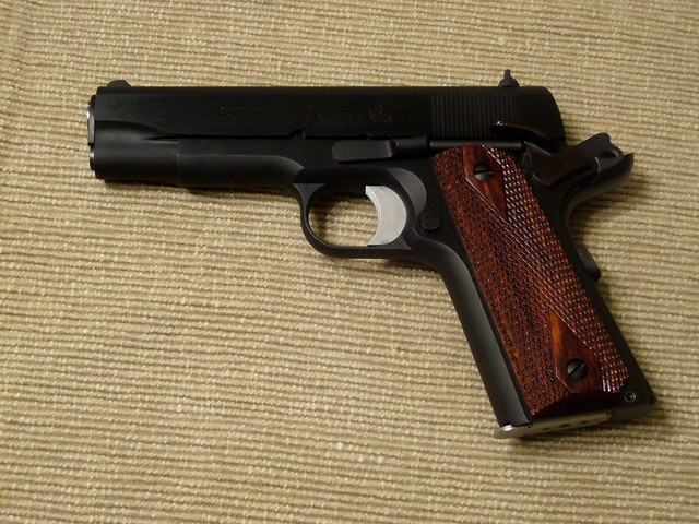

Granted I've shot several hundred rounds through my Colt but this was the first time at the range with the Glock.
Since I put a set of Meprolights on my Glock 17 I can hold a 5 inch group or so at 15 yards. Not a tack driver by any means, but in a self-defense situation, let's just say the bad guy is history, even with a group that size! But NO gun will be more dependable in a bad situation than a Glock. As far as accuracy.......much to be desired! I think it is the trigger for most 1911 guys. You get used to that smooth light trigger of a 1911 and then get to the hard mushy Glock trigger and everything goes downhill accuracy-wise. I just have lots of practice on my Glock so I am used to it and it doesn't affect me much. I just would take 100% reliability and dependability over tack driving accuracy any day. But that being said, 1911s are certainly great guns! Good to have a Colt my friend.
You could easily drop a 3.5 or 4.5 lb connector in that Glock 17. I bet your groups improve even if you've already had a lot of trigger time with that gun.
