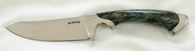

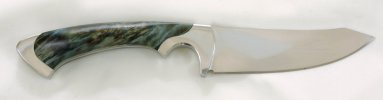

Made from 1/8” CPM154
Flat Ground Blade
Blade length: 4-1/4”
OAL: 9-1/4”
Weight: 6.2 oz
Bolsters: 303 Stainless
Handle Material: Stabilized Birch Burl
Sheath made by: Barbara McNeely19177.jpg
19177 right side.jpg 19177 top view.jpg 19177 bottom view.jpg 19177 Sheath.jpg 19177 and sheath.jpg 19177 in sheath.jpg
I like how the handle material is held without rivets showing, shows off the wood nice. Having a metal pommel is nice (I have had to drive tent pegs with the back in a rough use situation, good to have a knife it is possible to do that with) Good job!
Thank you sir. I have developed a system by which the handles are held stronger than by rivets. I had to remove the handles from a knife when an unseen flaw showed up in the handle and it took a cold chisel and about 45 minutes to remove all of the handle material. The bolsters are pinned and peened, then filed and sanded to make the pins disappear.
