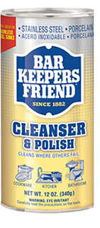

Bar Keepers Friend powder, mixed to a paste with some water and applied with a Q-tip to the spots, works well on these. Let it sit for maybe ~30 seconds (no longer than ~60 seconds), and rinse it off. No rubbing, scrubbing or abrasive sanding required. The oxalic acid in BKF will dissolve oxides of iron ('rust', in other words), and it actually works as advertised.
If you leave the BKF in place too long on the steel, even stainless steel, the oxalic acid can etch the finish. That's why you don't want to leave it on there too long (more than 60 seconds), and you won't need to anyway. Those stains look pretty light, so it should come off easily.

I was looking for BKF powder but I found 2 different kind. One say in blue (just lick a stick) at top “removes rust” another version I saw says “great for stainless steel” is it the same?
Thanks.
Thanks.
Not sure which products you're referring to.
This one (pictured below) is what I use and recommend; it's their standard oxalic acid-based powdered version:
Well, I live in Brazil, so I’ll have to import the BKF, but looking at eBay there was 2 kinds:
And sorry, it wasn’t written on blue stick. Actually is red stick shape at top.
Edit. By the way. Submerge my knife on water for 3 days doesn’t help to clean the rust just like worked on carbon steel plow disc.
