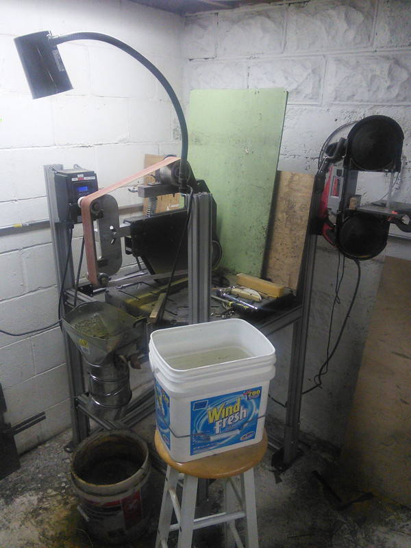

Can someone measure their 72 grinder depth for me? I know there is likely to be differences, but the two I'm kind of narrowing it down to are the ameribrade, and the alex steele one. I just can't seem to find a better price than those for the options. And sorry, I'm not confident enough in my fabrication skills to make my own. If I move a few things around I could likely mount it right where I have the current 2x28, and make a bit wider walking path. I just want to know how far out over the bench I have it will likely hang over. Bench depth is about 21".
Thanks in advance.
29 inches from back of grinder to front of my dust shoot
With 2" wheels and platen
The 29" is front to back.
Please excuse the Mess
